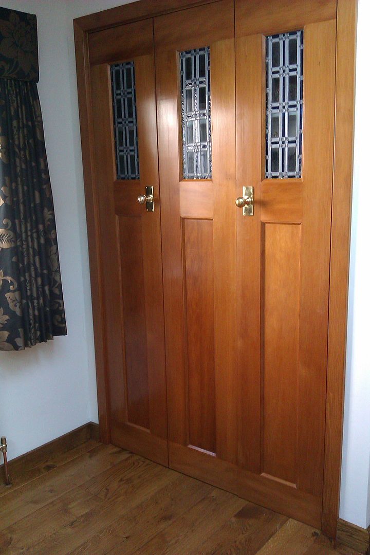

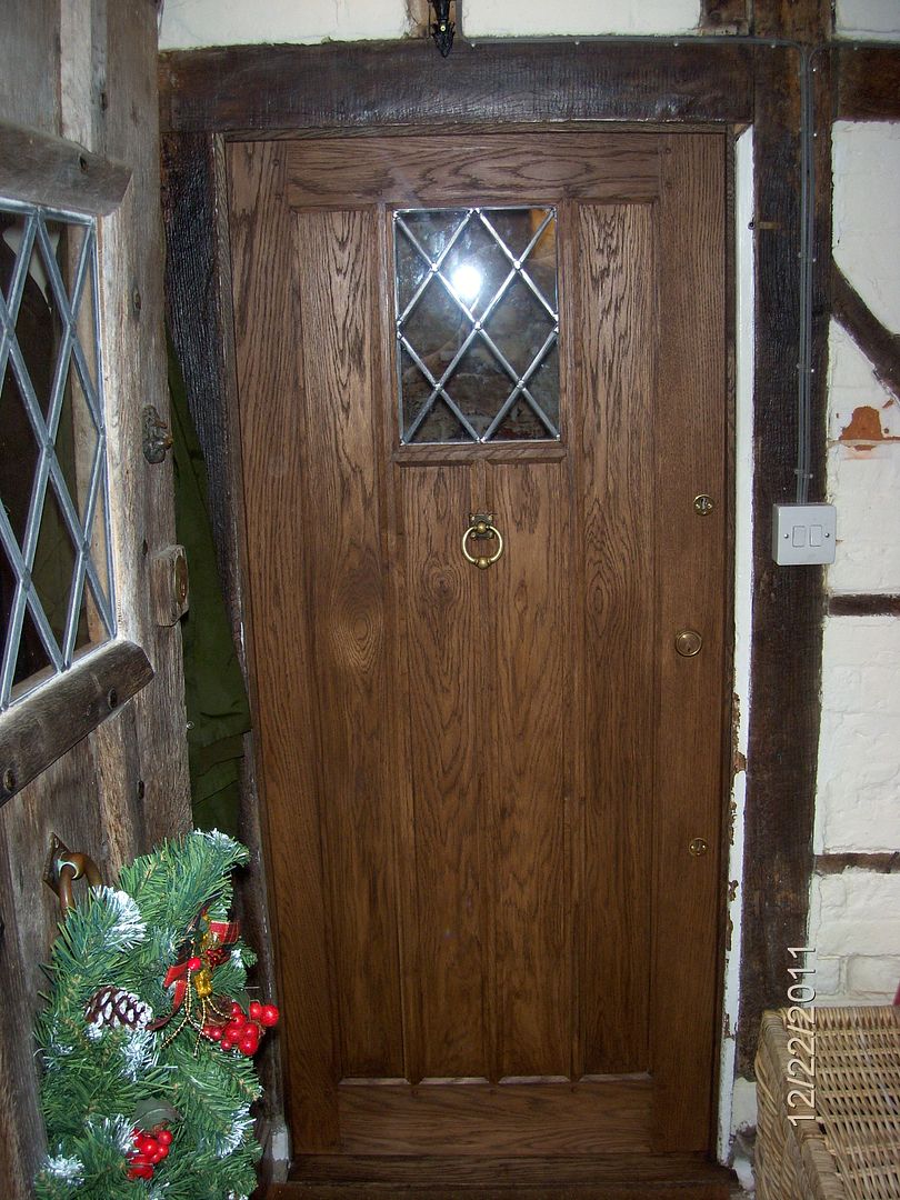

You can always cut your own veneers from timber reclaimed from your house and stick that to a bit of MDF, these three were done that way with a couple of lengths of cladding off a beam cut very thin

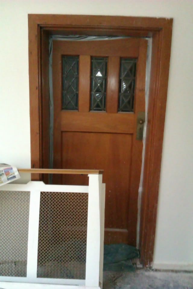

Tried to match this ones with the glass out of the old front door

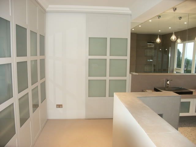

This 2700x 1000 sliding door is a single large press sheet of MDF with assitional strips each side to form teh shaker panels, larger one side to also form the glass rebate. The wardrobe doors you should find my loose tongue method on UKW for how they are made
