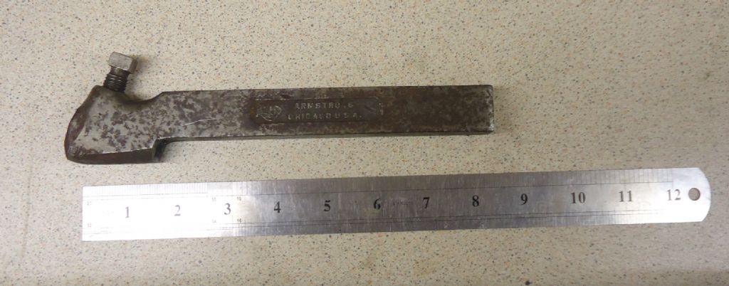

I have an old American tool holder.
It needed thinning down by .080" to fit in the lantern tool post on my newly refurbed shaper. It was going to be tough going though as it was case hardened. To give you an idea how hard it was a new coarse file just skidded of the surface - glass like it was.
It seemed like a suitable first job for the Alba to tackle. With a .040" deep cut and a .006" feed it removed the necessary material in one pass from side "A".
Side "B" next and it looked like this:

That style of tool holder with the built in rake is really meant for lathe use...the ones meant for a shaper usually have the HSS tool bit set parallel to the shank. Don't let this bother you too much, they will work fine but are more likely to chatter and pull into the job than the "proper" shaper ones. This has not stopped me doing a lot of good work with a set of three Jones and Shipman ones that came with my Alba 1A. (Left, right, and straight.) But if you happen to see a shaper one going somewhere grab it.
The other trick would have been to open out the tool post slightly. I have done that on one of mine.
There are some pictures of some shaper tools in my album here:
Shaper tooling
Not counting the car keys which are just for scale. None of these are the shaper equivalent of the one you have, although I do have one somewhere. The two big ones on the right are quite good, except that you can't use short pieces of HSS in them.You can make one of this type from an old steel bicycle crank. But you can adjust the angle of the tool bit for doing corners.

Thanks for the info John. I have never used such an ancient tool before - I guess it must date to the first half of the last century - so I had no idea that it was not entirely appropriate for use on a shaper. I'll give it a go anyway!

May not be such an "ancient" tool - very similar holders are still available new from places like Cromwell tools today.

If you do find that the tool tends to try to dig in or chatter, you can always grind the tip a little to reduce the built in rake. They are handy even if not quite ideal, since they bring the tool out away from the slide a bit, which can help in getting into corners and so on. I use my left and right hand ones with long narrow angle bits when I do dovetails.
You will notice that most of the tools shown in my picture have an offset to put the cutting edge behind the mounting surface. The theory behind this is that when the tool flexes (as it will) the flex will tend to reduce the depth of cut. If the cutting edge is in front of the mounting surface, flex will tend to increase the depth of cut, tending to cause digging in or chatter. However, if things are rigid enough and the cuts not excessive, you will get away with it.
