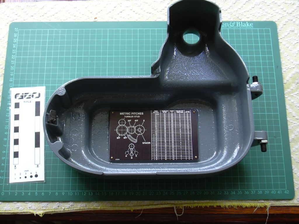

I don't think I've ever posted on this thread before. My activities today are small but the culmination of a project I've been anxious to complete successfully.
First of all, a bit of background: some time ago I fitted a quick-change gear-box to my Myford ML7 lathe. I bought this particular gear-box second-hand - it had previously been fitted to a Super Seven. I was advised that the change gear backplate that came with the gear-box would fit the ML7 but that I would need a new change gear cover. (Is it OK to refer to them as 'change gears' when all they do is connect the tumbler gear to the input shaft of the gear-box? ) I was further advised that Mytholmroyd Myford were offering the correct cover but only as a raw casting, no holes drilled or tapped and no paint-job. Before yesterday, I had fettled the casting, drilled and tapped most of the holes and a kind neighbour had spray-painted the casting for me. All that remained was the fitting of the label within the cover.
Here's the first picture:
This morning, I fitted the label using the four 'brassed' drive screws. I had drilled the holes in the casting yesterday after taking some time deciding what depth they should be.
The photo shows that the label is fitted on the top of an 'island' in the casting of the gear cover. It's obviously desirable to avoid drilling the holes too deep and breaking out on the exterior surface of the cover. I had thought of posting this as a new thread entitled 'Using the drill-press as a depth gauge'; that's just what I had to do to discover how much meat there was in the casting.
Because of the depth of the cover casting, the thickness of the 'island' can't be measured with a micrometer or a vernier caliper. I have seen calipers with curved legs and that have a built-in dial gauge but I don't have one of those. The method I employed was as follows:
I mounted the drill in the chuck of the drill press and lowered it until it contacted the machine table gently but firmly. I then locked the drill quill and wound down the twin nuts of the depth gauge until they contacted the head-stock lug. I then released the quill and wangled the gear cover under the drill and lowered the quill again until the drill contacted the surface of the casting within the label mounting area. The space between the twin nuts and the headstock lug was now equal to the thickness of the casting. My vernier caliper wouldn't fit there because the tail of the caliper fouled various features of the drill-press headstock so I used a stack of feeler gauge blades to fill the gap and measured their total thickness using the caliper. By comparison of the length of the drive screws with the thickness of the label and the measurement previously described I decided I needed to limit the depth of my drilling to 200 thou. I reset the drill-press twin nuts accordingly, held my breath and drilled the four holes. I had actually performed the measurement process several times, using various probes in the drill press and had also considered several other procedures.
Lateral position of the holes was dictated by the four dimples that Beeston Myford considerately provided in the surface of the label 'island'. I checked the position of the drilled holes by laying the label in position and inserting four half-toothpicks through the label into the holes in the casting. That gave me the confidence to fit the four drive screws after which I emitted a big sigh of relief! The depth of the cover casting prevents the use of just a hammer - I used a punch. That necessitated assistance from SWMBO to hold the casting steady.
Regarding the painting part of the project: I bought half a litre of Myford Grey enamel, some thinners and some etch primer from Paragon Paints. I was amazed that my neighbour's spray painting used only a couple of eggcup-fulls of the enamel!
I admit that I was scared that I might drill too deep and break out on the exterior surface of the cover casting so I did try securing the label with double-sided adhesive tape. This didn't work because the tape and the painted surface of the 'island' weren't compatible. I think it would have worked if we'd masked -off the 'island'.
All you gurus are probably thinking 'this is trivial stuff, why is he making so much of it?'. Well, I'm jolly pleased with the result so here are some more photos:
Best regards,
Swarf, Mostly!
Edited By Swarf, Mostly! on 05/08/2022 16:49:41

Hi Swarf Mostly, looks good to me.
Regards Nick.
