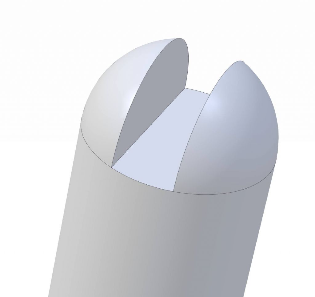

20/11/2022 17:03:21
I've come across a water service valve buried in house wall. It's an isolation for exterior tap, and the only access (without pulling wall apart) is down a small hole perhaps 10mm diameter.
Rather than the standard screwdriver slot to twist the ball, this valve has a raised bar across a rounded dimple.
I speculate that the key/tool to operate it would look like
I've searched on-line for similar valves, or the tool to operate, but have failed to find anything. Does anyone here know a name for valves of this type? or where I can get a key?
I can make a key, but will be largely guesswork as measuring down the access hole is not easy.
