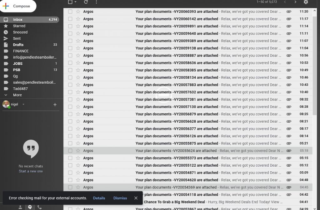

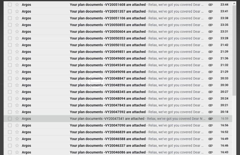

26/01/2020 08:02:22
Im currently getting a new one every three minutes. I rang them - they said someone musy have pressed a wrong button. Well if thats the case theyve been up all night and are still pressing it
26/01/2020 00:18:55
And so it continues.......
25/01/2020 20:31:18
Now at 28 and counting. Me thinks there is a tiny fault somewhere in their software!
25/01/2020 17:33:51
I bought a new Dremel yesterday and opted for the extended warranty - so far they have sent me 18 extended warranty policies, each one a different number. I hope they arent billing me for these! If any of you work for Argos...what?????
