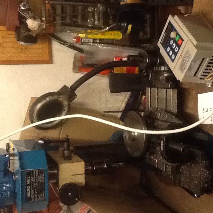

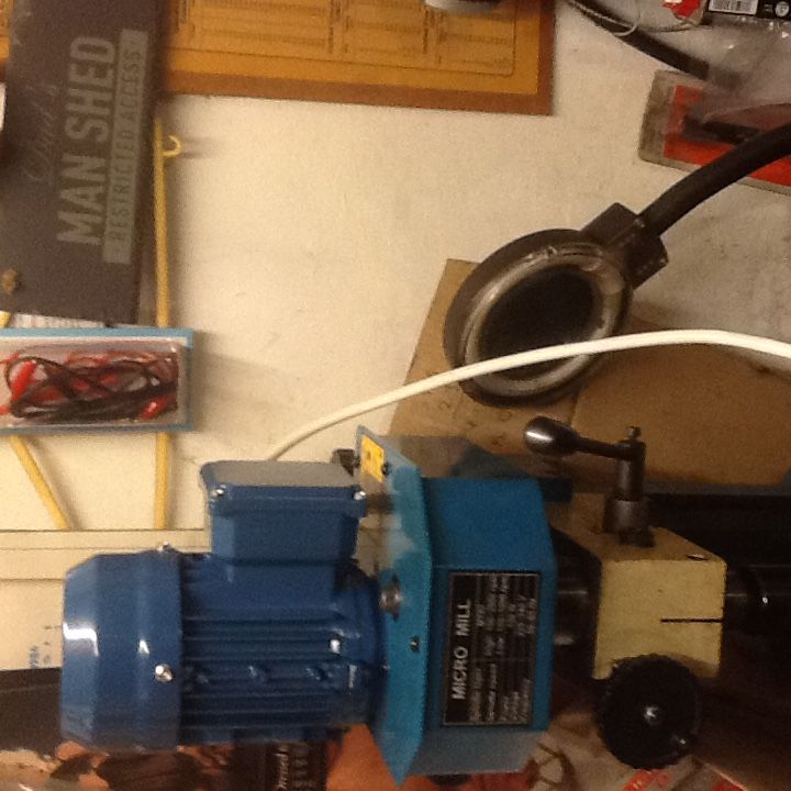

14/12/2019 21:08:34
I decided to go for it, motor came from Inverter drive supermarket or something like that, bit miffed when I ordered it that their quoted prices don't include VAT so it was £9 carriage plus £9 VAT so final price was closer to £50 than £35, hey ho, it came in 24hrs, well packed and allegedly made in Portugal. First mechanical job was to transfer and drill new holes for the mounting bolts, motor was a universal mount so used 2 of the cap screws that held one of the feet on as I didn't need the feet! The other two bolts had to be turned down hex heads to get the clearance on the mating gear. Then had to set up the nylon drive gear which was as slack as a yak on the old 8mm motor spindle to open it out to 9mm. Easy enough then had to open out the keyway deeper. Then needed a couple of spacers with keyways to clear the key and get the gear in the right position relative to the input gear on the two speed shaft, had a bar end of free cutting stainless on the bench the right OD so used that for the spacers and a new clamp washer. Reassembled and connected the VFD (currently laying on bench) programmed it up for. 4 pole motor max 75hz so I can if I want match the old top speed (never really used that much though), switched on expecting the lights to go out and she burst into life! All works as it should, about as noisy as it was before and the advantage the VFD allows an instant reverse of direction which will be handy for power tapping. Despite following the terminals faithfully I had to swap 2 phases to get it to run forward when the VFD indication said fwd! Not cut any metal yet as the battery drill was flat and I have to screw the box on the wall, tomorrow for that, so far so good!
6 wall plugs and a couple of cable clips and we are away! One improvement is the old DC drive knocked out Planet Rock on the dab workshop radio as soon as it was switched on, no problem now! Sorry about the last two sideways pictures!
Paul.

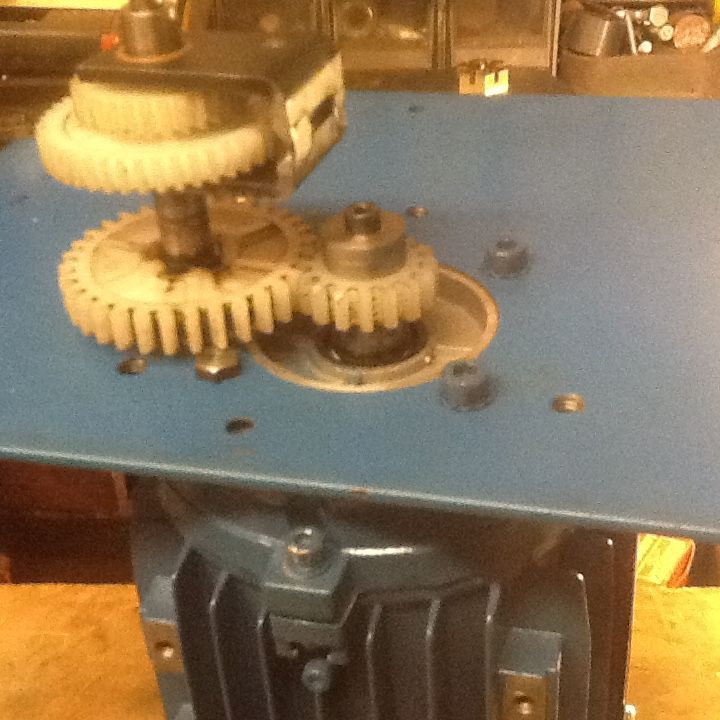

09/12/2019 22:05:28
Thanks gents,
Replies in turn;
Ron, I had a mate who knows a lot more about these things than I do some calculations and he reckons the three phase due to the difference input / output ratings will give me slightly more power than the original. Unfortunately the next motor up has a 60mm spigot and as the end plate is recessed inside there isn't enough meat to turn it down to 50mm. I could open up the hole in the existing plate but there will be little room left for the motor holding bolts so given the info above I am going to give it a go, little to lose!
Michael, I have not had the gear selector rattle but I have broken it twice! Second time I realised what was happening with the poor fitting short radiused end of the key which was effectively jacking the gears apart first time I bought a new one but second time I welded it back together and since sorting the key issue have had no more problems. The motor gear gets loose on the shaft, I assume that is a combination of heat through the spindle and load. With the new motor the spindle is 1mm larger so I can bore out the gear to a good fit and cut a new keyway, the 3ph should run cooler as it has a fan so that may improve too.

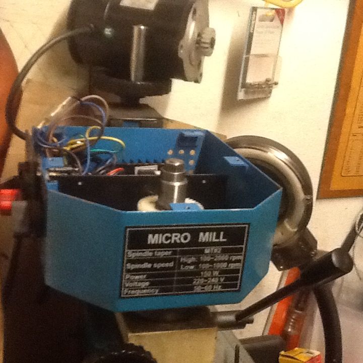

08/12/2019 22:05:03
Well it's happened again! My long suffering micro mill has stopped going round! Last time I used it I had a problem but poking around in the controller seemed to set it off again. Today, no chance. Plug in, all good, switch to fwd, green light comes on as it should, turn the pot on to make it revolve, orange light comes on (as it would if the overload had tripped), no motion! Same in reverse. Quick prod about inside with a meter reveals no volts to the motor under any condition. Yes the fuse is good.
Given the limited space in my workshop at home it's a handy little machine but on the limit of things I do! Generally though it puts up with it although I have had my share of broken gear selectors and split gears and on a marathon session with no regard to the temperature of the motor burnt it out. A new motor was £100!
i have checked the motor and the resistance seems good, brushes are good so this time I think it's something on the control board, there is nothing obviously fried though.
i have a spare inverter (well 2 actually) and looking around I can get a 3ph 240v motor rated at 0.12kw at 2700 50hz but continuously rated between 5 and 75hz 200 to 4050 rpm for £35! Original set up is 240v AC in, 230v DC out to a 4000rpm 150w motor. Anyone think I will notice the difference?
