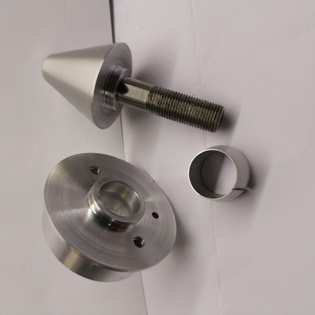

Cleaned up some parts made for a model engine spinner assembly, collet, backplate and front nut with Titanium stud threaded M8x.75.
2x2.5mm holes provided for tapping M3 for drawer attachment, 1x2mm hole for a prop drive pin in the front.
Balancing slot at back and TDC mark on OD.
Both spigots fit into the moulded hub of the prop and the through hole is 4mm for a tommy bar.
These are used with the spinner hub type laminated/moulded props on pylon racing engines.
