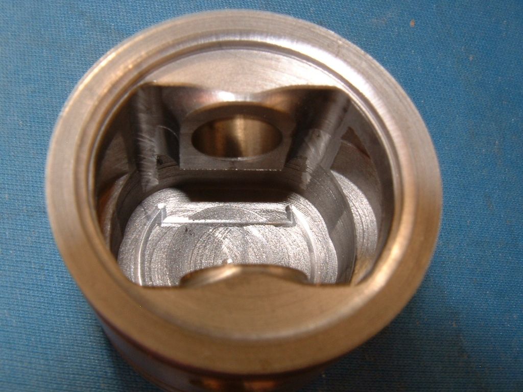

Thread: Advantages of cast iron rounds
02/12/2015 17:08:06
Picture shows the inside of a cast iron piston made for an ETWestbury designed engine that was fitted to a field charger used for charging radio transmitters in the field during WW2. The engine/charger assembly was parachuted in to the agent/resistance.
The original piston was made from a casting and had 2 top compression rings and an oil scraper ring close to the skirt, the small lip below the bottom ring failed and a large part of the piston broke away. The new piston was some 20% heavier than the original.
Emgee
