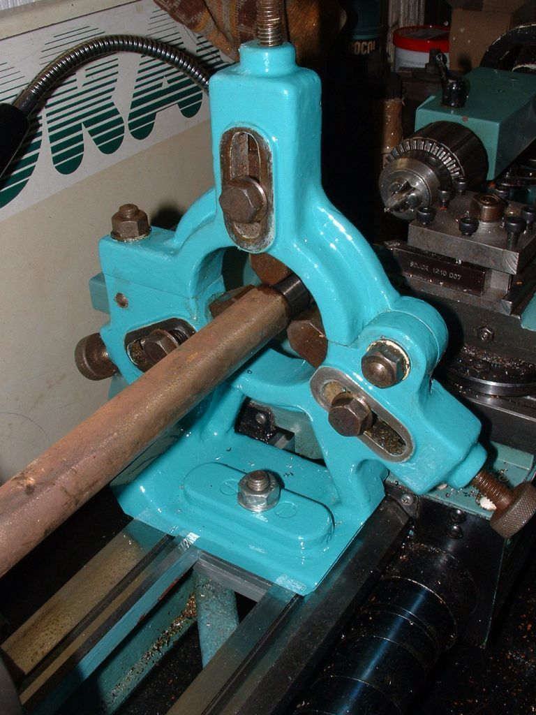

Thread: Correct Performance of Fixed Steadies
17/12/2015 17:25:21
Denford steady in use, nylon collar fitted over work and clamped on with a Jubilee clip, saves running steel fingers on the aluminium tube of the tuned pipe.
Emgee
16/12/2015 20:07:05
Another substantial fixed steady on a Denford Orac, modified base to suit this lathe, very sturdy.
Emgee.
