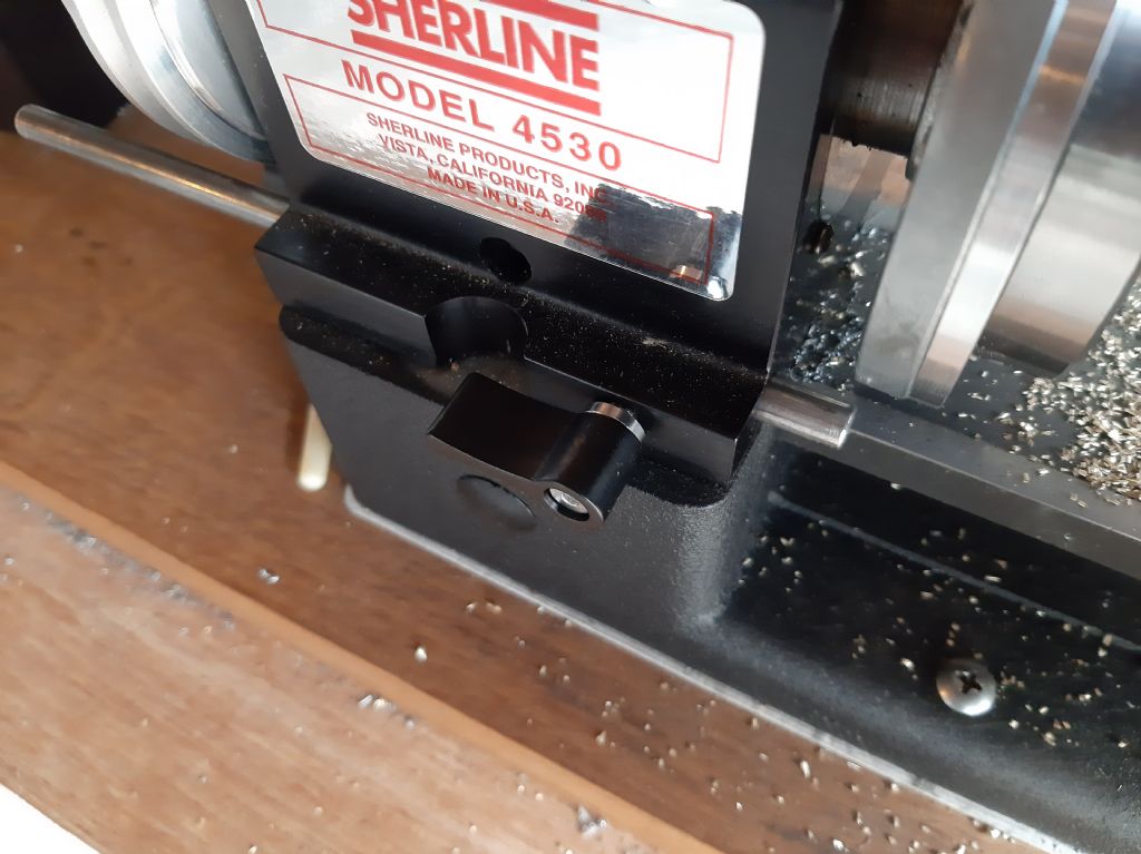

11/05/2022 23:42:03
Hi ega,
Yes they do work well and are much better than using a tee key.
I opted to change the thread on the sherline from 10-32 to 5mm. Not a problem as the pitches are almost identical at 32 and 31.75 and the 5mm tap removes just a small amount of metal from the 3/16" 10-32 thread.
I've just bought these on ali express to fit the tool posts on the sherline. With postage tax and a £5 discount I get 4 levers for £4.01p, yes £4.01p
20220511_232554.jpggeoff

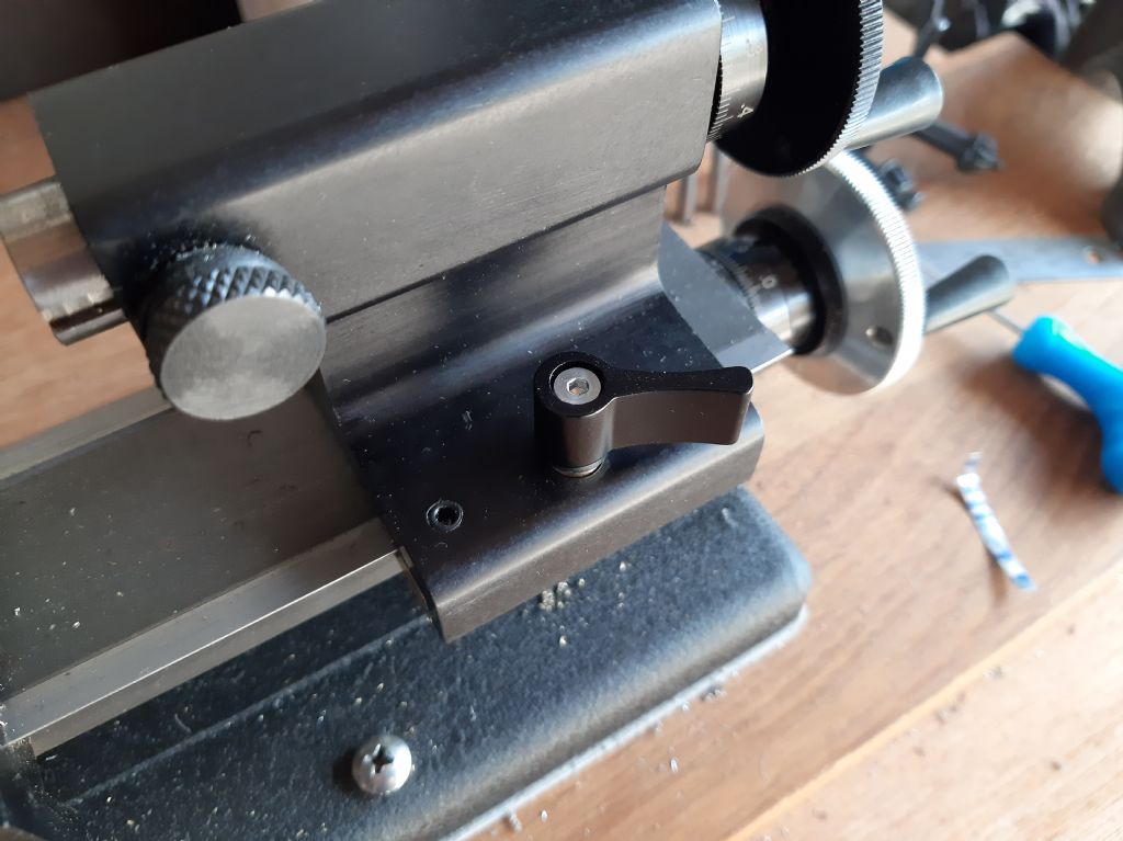

22/04/2022 18:52:07
Hi eva,
Yes they are a useful addition to the lathe.
Forgot to mention they are spring loaded around a hexagonal top so are adjustable for position.
No it may look like blue tack but it's just a cardboard cereal box base. Just felt a little compression was a good idea when mounting the lathe on the baseboard
Geoff
22/04/2022 16:12:15
Just received some mini locking levers from the far east.
Installed one on the tailstock and one on the cross slide stop.
Really pleased with them, I would guess most sherline users get fed up reaching for the tee key and I'm no exception.
5mm thread so you need to re thread with 5mm tap.
Got them off ali express at jadkinsta official store, cheap as chips, £2.38 for the two.20220422_154051.jpg
Geoff
