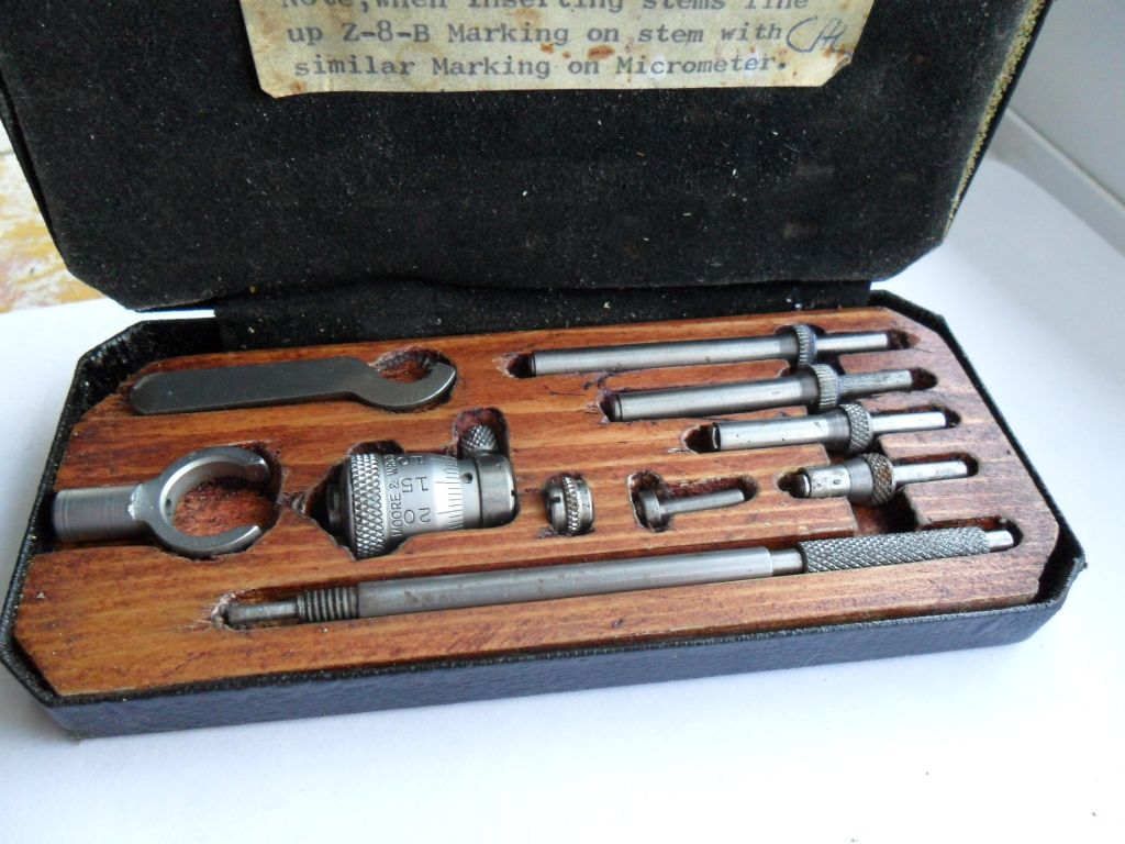

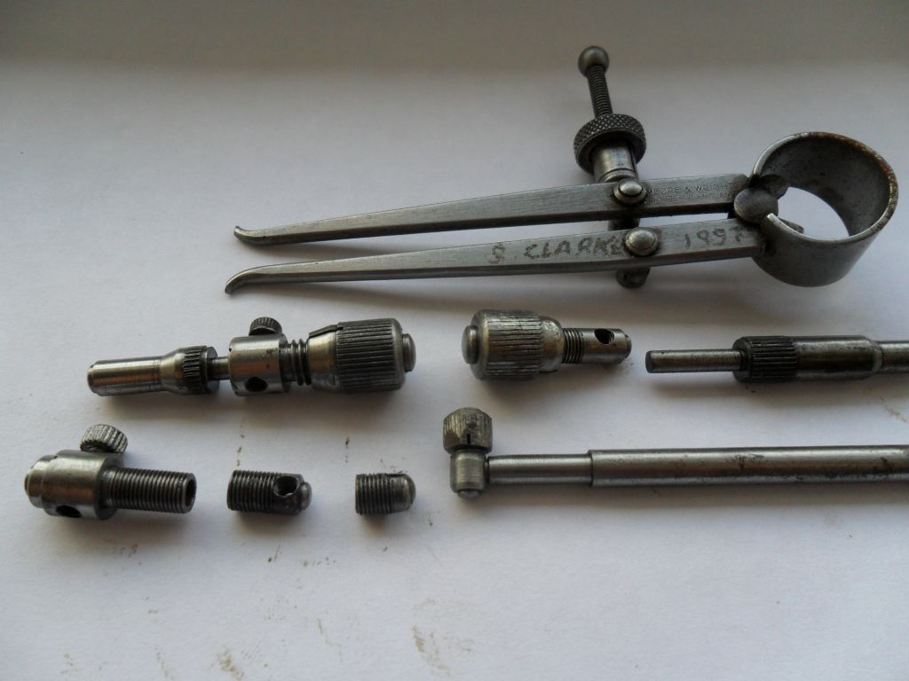

As Bob says .you may wont to check holes for roundness, bell mouthed etc inside calipers are tended to be forgotten in this digital age . I always talk now about the home shop machinist not industry . you can measure deep into the hole you are boring . I have also made some gauges similar to inside micrometers but have to be measured with a micrometer I also have a metric M&W set Nobbymoore wright
measure bores

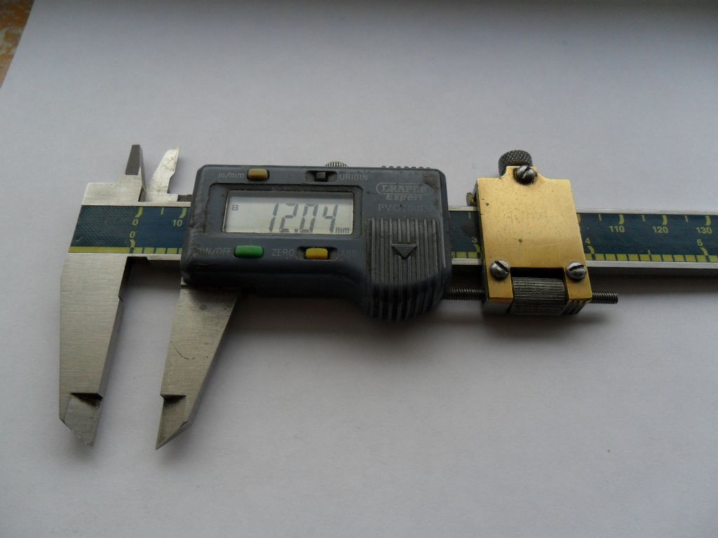

I added fine adjustment to my digital caliper
Nobbycaliper
