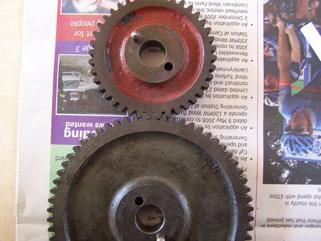

Eugene03/11/2014 10:28:40
131 forum posts
12 photos
Be aware that there are some changewheels in the wild that whilst strongly resembling the "normal" Drummond / Myford ones, don't actually fit.
The part set I had off E-Bay had variable centre bores and slightly different pin positions from the ones on my M Type. The tooth numbers were cast in, so that may be a warning sign.
The red painted one is the E-Bay purchase, the green one a postwar Myford. The pin position is sufficiently different to prevent them sitting together on the spindle. They can (hopefully!) be bodged.
Eug
