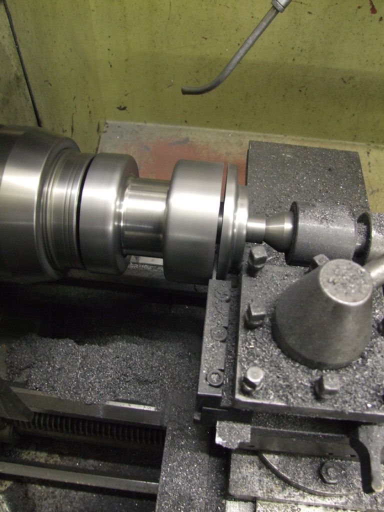

Posted by Hopper on 22/06/2023 07:47:40:
...centre drill the end and put a tailstock centre in place to stabilise it...
Like this, on a 3.5" diameter workpiece mounted on an homemade expanding mandrel:
Parting Front Wheel Hub
