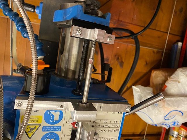

31/05/2020 22:05:20
I have finally! (just) completed making the the parts and installed the magnetic DRO to the Z axis of my Chester Super Lux milling machine. Why is it the warranty always expires long before the components come into use. The installation comprises two alloy mounting brackets carrying two 8 mm linear bearings with an 8 mm shaft to which the the encoder is fitted using a machined alloy adaptor. The magnetic scale carrier is mounted between the two mounting brackets with provision for adjustment. An alloy carrier is fixed to the quill shoe via a 90 deg.folded steel bracket all works well and now I only need to look at one console when setting up.
The advantage of this design is the lack of slop in the encoder travel and no overhanging structures introducing inaccuracies in the z axis reading. The quill return spring acts sharply.
I am indebted to various forum members for inspiration along the way.
I will attempt to make a separate posting with the relevant images.
Robert Butler
