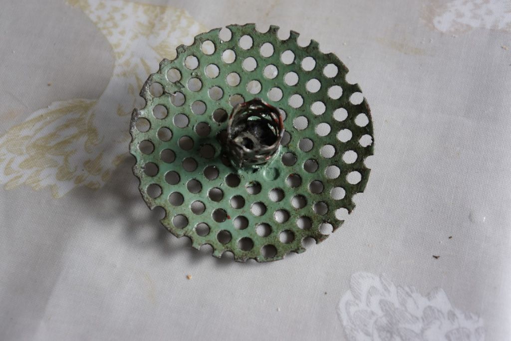

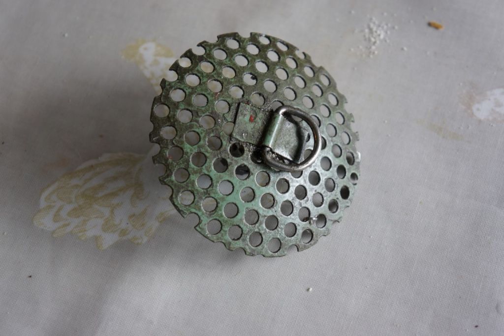

30/07/2014 11:45:32
dsc02085 (medium).jpgHeres a picture of I presume a genuine one off a student lathe
