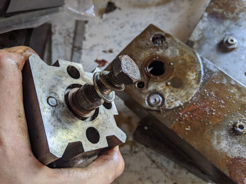

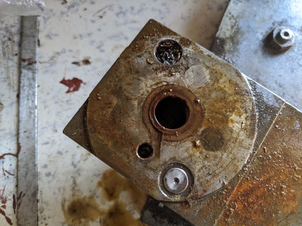

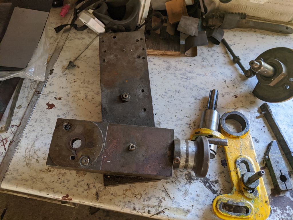

Richard Kirkman 129/07/2020 14:53:20
334 forum posts
799 photos
Just for reference, I just received a spare whole cross slide with QCTP attached. Looks like it's just been chopped off and flattened, then a bolt has been used to secure it. However, the actual slide has not been tapped.
