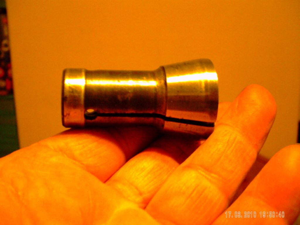

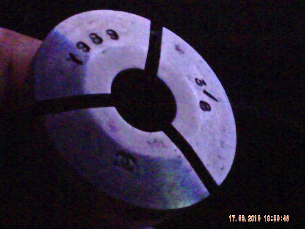

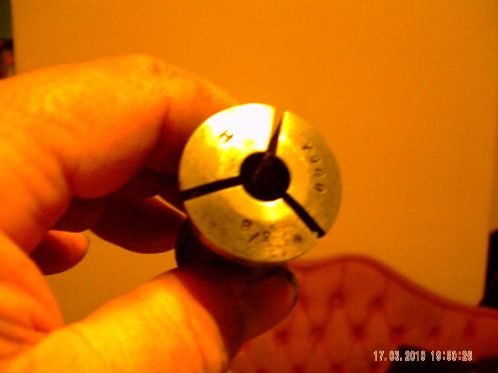

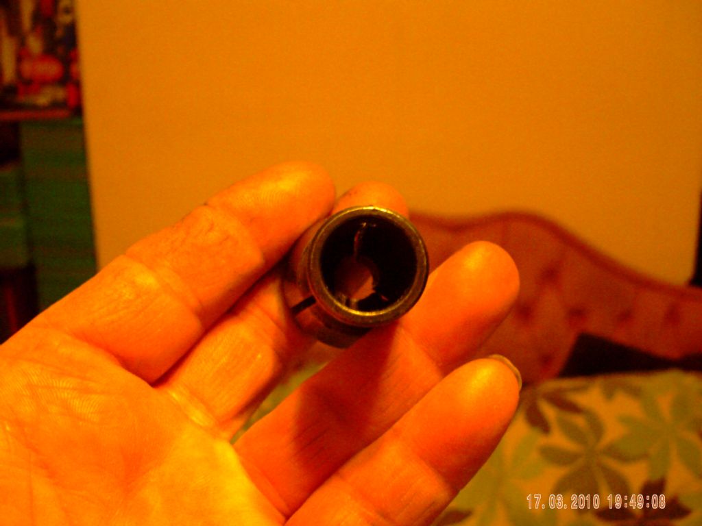

The Rotagrip collets are different to mine heres a pic of one of mine:
The machine dosen't vibrate too much and what it does vibrate I think I can put down to a slightly bent table drive spindle and the Brammer belts it has, as to the spanners I dont have any at all looks like I will have to make some if you can remember what they looked like that would be great
Regards
Paul
