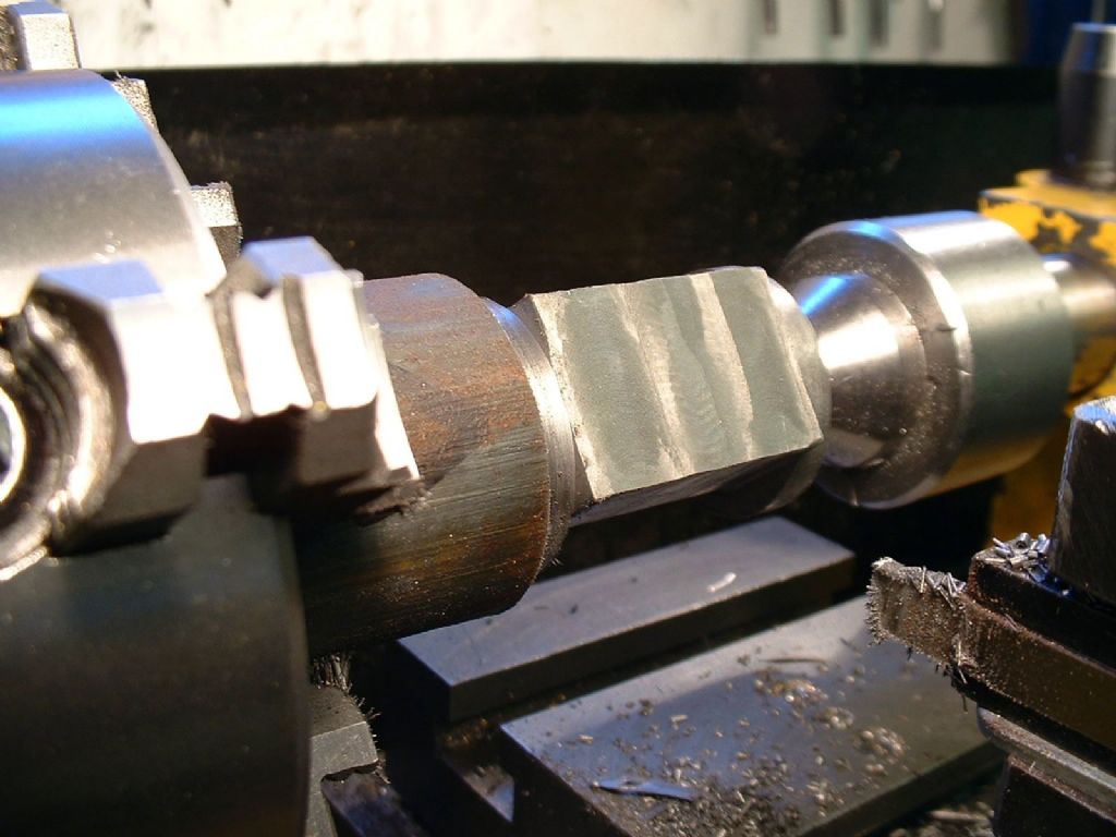

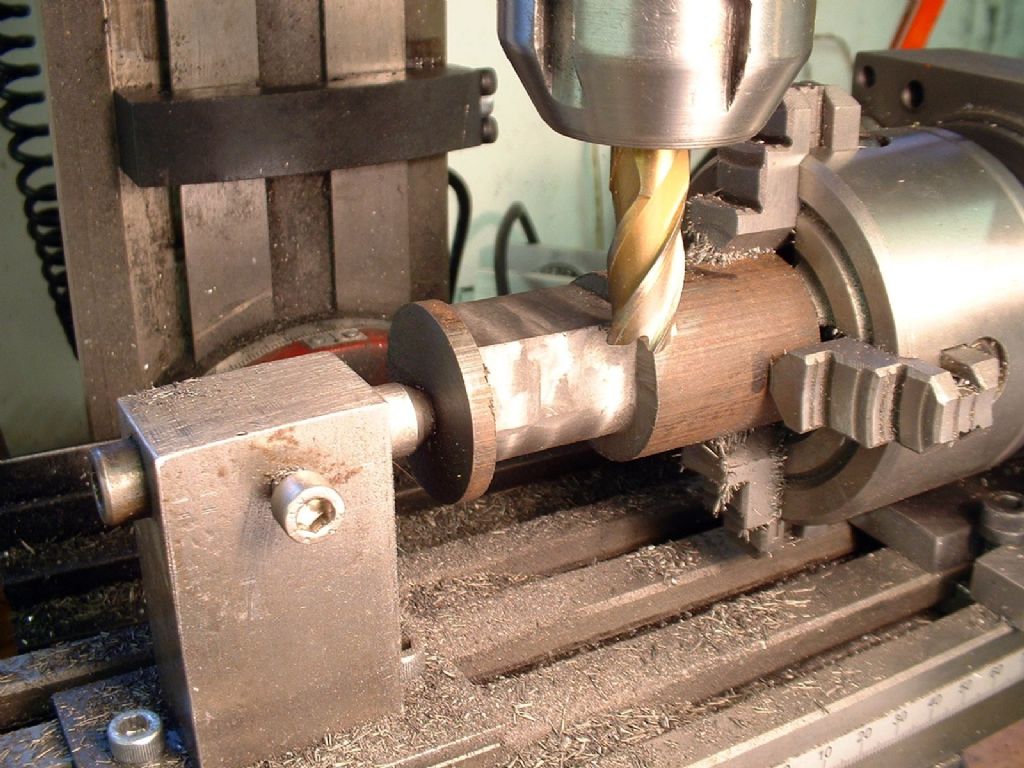

The cylinder shape was now starting to appear. I returned it, still in the chuck, to the lathe and turned down the flanges to size. One of these had to be done using a parting tool. I was nervous about taking an interrupted cut through the surface of an iron casting with a parting tool. Fortunately the minimal skin and excellent cutting properties of the bar meant that I had no difficulty. In retrospect it might have been wise to take the 'skin' off the bar before setting it up eccentrically, just in case.
23/01/2010 19:56:44

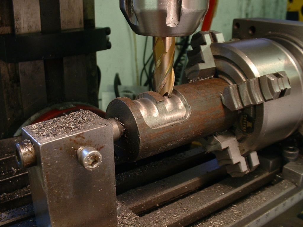

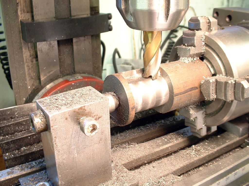

4. Finally, the rotary table was locked with what would become the slide face uppermost. I made the mistake of removing all the material in one go and didn't get a very good finish, but didn't realise this immediately. This meant I had to re-finish the valve face later.
Edited By Neil on 23/01/2010 19:58:22
23/01/2010 19:55:37
3. Measuring across the diameter of the curved surface it was apparent that it needed to be reduced by just over 3/8". This was done in just two cuts feeding in 3/32 each time. For the first cut the depth was much more than 3/32" once the cylinder had been rotated - about 1/4" in fact, but this did not cause any problems. As well as machining the curve around the back of the cylinder, the cross slide was used to form the sides of the valve faces. For these final cuts across the sides of the cylinder the rotary table was locked.
23/01/2010 19:54:04
Still in the chuck, I moved the whole caboodle onto a rotary table on the milling machine, supporting the bar with a tailstock in the pre-drilled centre. I had previously adjusted the rotary table to minimise backlash. I then used a 1/2" four flute endmill to shape the outside of the cylinder. For the record, I ran the mill at 900rpm. The milling was carried out in the following stages:
1. Line up the centre line of the cutter with that of the cylinder. Set index to zero and note the reading when approaching from the other direction to allow for backlash. Orient the bar so the 'low point' (which will become the far side of the cylinder from the valve face) is on top. Take two skimming cuts at 3/4" spacing to mark the width of the inner flange faces 1 1/4" inches apart. Index reading in one direction set to zero, note that in the other direction (note this is not the expected value of 1.25”, due to backlash).
2. Set the cutter over to one end of the cut and on the cylinder centre line. Gently rotate the work through just over 90° (not critical). Set the rotary table index to zero. Move the cutter across to the other flange and turn the table back 183°. Return to the first flange and then retract the cross slide to clear the cutter from the work. One can now see the indication of where the curved surface of the bar has to be machined away, and defined what will be the start of the slightly tapering (to simulate the draft on a casting) flat sides of the valve face
23/01/2010 19:52:37

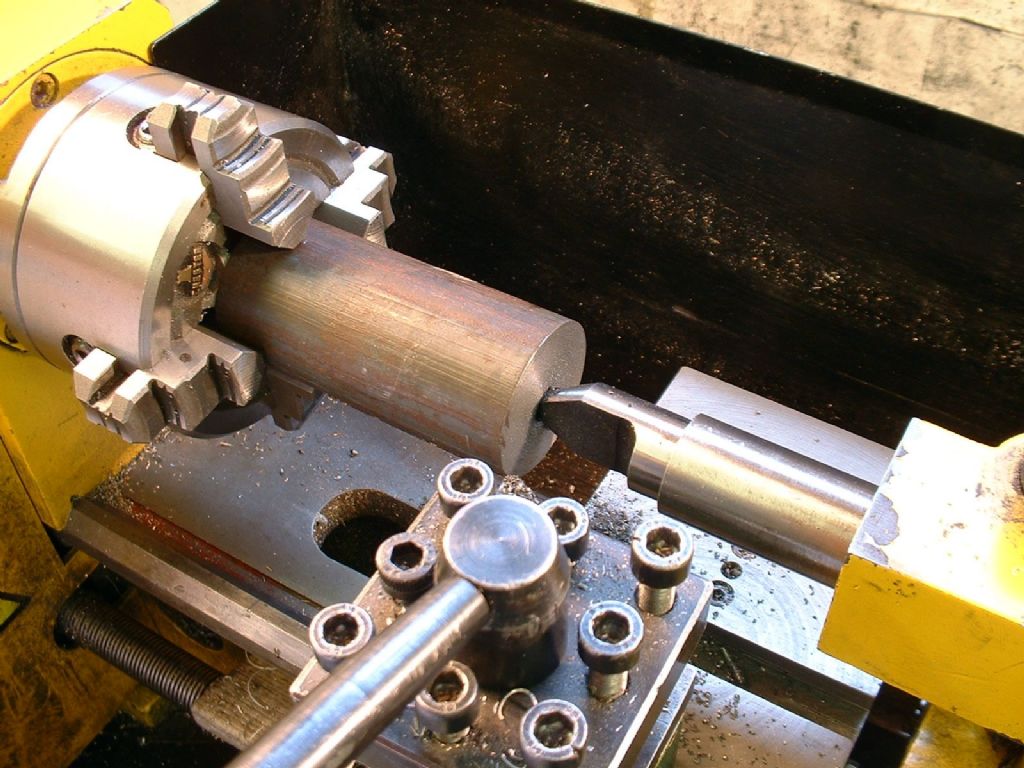

A few years ago I worked out a method for easily machining flanged cylinders from solid cast iron bar. There is very little waste, and is a good way to use up bar ends so I thought folk might be interested in a photo-guide.
The example cylinder in question has a nice shape, being fairly tall and having angled sides that taper into the valve face. This shape lends itself to being machined rather more easily than when the valve face is joined to the cylinder by a marked step.
I used Corel Draw, a vector drawing programme, rather than full CAD, to produce my drawings. One of the advantages of using the computer is being able to move things around to see if they fit. In this case I was able to see that there was plenty of room for the cylinder, including the valve face, in a 1 1/4" continuous-cast meehanite bar. This was obtained from College engineering and machined beautifully with no hard spots and very little 'skin'.
An eccentricity of roughly 9/64" would leave a machining allowance all around the casting. I set the bar in my 4-jaw chuck using the tip of a tool in the toolpost and a 9/64” drill to gauge the offset. Greater accuracy was not needed. I then centre drilled the bar and faced the end, supporting it with a half-centre (photo 1).

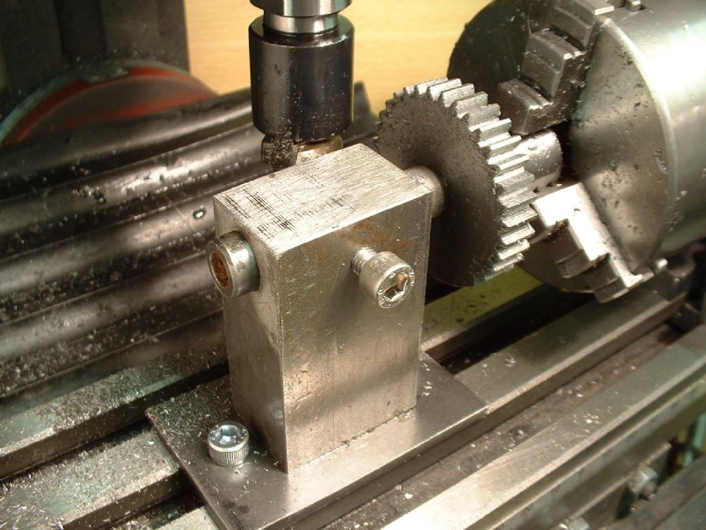

My dividing head  mounts my mini lathe chuck. The spindle and body were two huge lumps of cast iron from college engineering, and I 'free hobbed' the gear at a second attempt (number 1 had 61 teeth!) It looks a bit agricultural, but it does the job. I also made a boring head and a ER25 collet holder (which was in ME about 9 years ago).

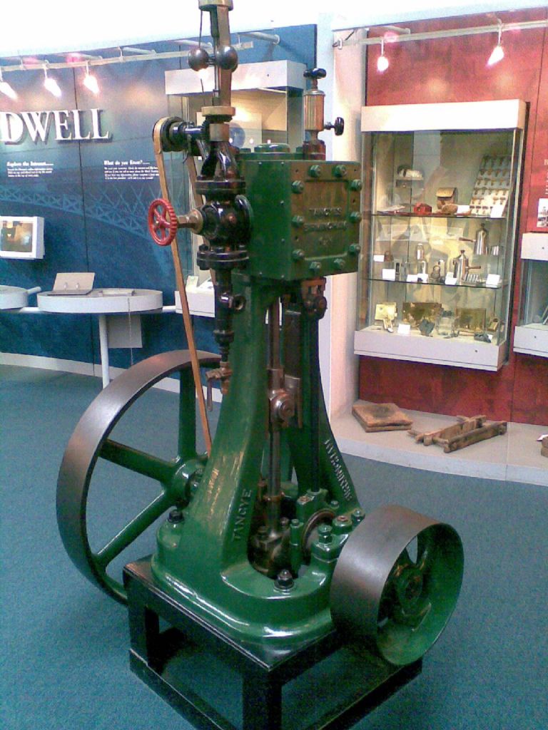

I recently posted pictures of couple of full size engines in my albums - even the models  are real engines
This Tangye engine at the Black Country Museum is not too far from a Stuart 10V at all!
There are truckloads of engine about, if you look
