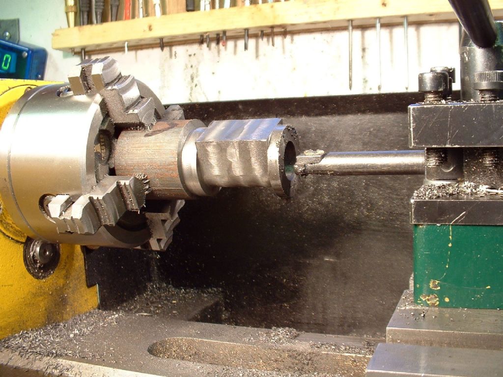

The cylinder shape was now starting to appear. I returned it, still in the chuck, to the lathe and turned down the flanges to size. One of these had to be done using a parting tool. I was nervous about taking an interrupted cut through the surface of an iron casting with a parting tool. Fortunately the minimal skin and excellent cutting properties of the bar meant that I had no difficulty. In retrospect it might have been wise to take the 'skin' off the bar before setting it up eccentrically, just in case.
Stub Mandrel23/01/2010 20:02:58
avatar
4318 forum posts
291 photos
1 articles
I decide it would be sensible to drill and then bore the cylinder while it was set up accurately centred in the chuck. I went up using several drill sizes in order to avoid any risk of a drill jamming and spoiling the set up. Final boring was done dead slow with cutting oil and the tip of the boring tool stoned to a gentle curve. The reward was the lovely satin grey finish that is ideal for a steam cylinder.

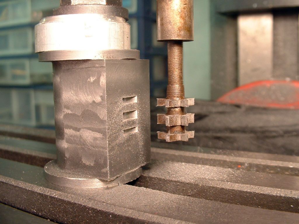

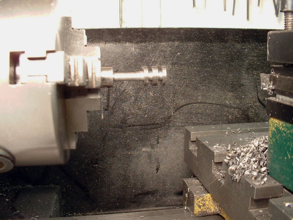

I had to decide on my own valve dimensions.  I decided on steam port width and spacing of 1/16", exhaust port width of 3/32” and port length: 5/16". The ports can be milled out, but for guaranteed accuracy there is nothing to beat a simple ganged cutter as advocated by LBSC.
A small diameter cutter is needed, in order to get a reasonable port depth. In this case to get a width of 5/16 and a depth of approximately 1/16" a  cutter from 3/8" silver steel was chosen. Using a 1/16" wide parting tool I made a tool blank in the form of three disks on a shank. The end disks being 1/16" wide and the centre disk 3/32". The shank had to be long enough to clear the entire slide face and the top flange.
Stub Mandrel23/01/2010 20:10:23
avatar
4318 forum posts
291 photos
1 articles
I milled six teeth on the cutter following a sketch by Edgar Westbury in his M.E. series on ‘Unicorn’. This requires milling very large ‘bites’ with the cutter lined up on the centre line of the blank, in order to create pointed teeth with no top rake, and a very small witness at the tip.
With the cutter running fast, but with a slow feed I had no problems with 'grab'. I indexed the blank by eye, as uneven tooth spacing is actually an advantage in this type of cutter, reducing the danger of resonant effects causing chatter. I carefully cleaned up the sides of the teeth with a file. I hardened the whole cutter then tempered it in the oven. I wanted to temper it a bit further than the usual pale straw, as it looked very fragile. I decided to start at gas mark seven (which is supposed to be about 220°/pale straw) knowing the oven thermostat was inaccurate by about one mark. This was just as well, as after a false start (my wife turned off the 'empty' oven), the cutter came out an even pale bronze colour that probably equates to dark straw. I used a diamond slip to clean up the sides of the teeth and to put a shine on the cutting faces.
Stub Mandrel23/01/2010 20:11:46
avatar
4318 forum posts
291 photos
1 articles

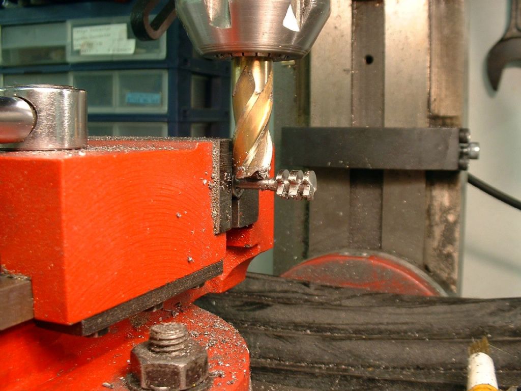

I clamped the cylinder to the milling table (you could equally clamp it to the vertical slide on a lathe), with the valve face perpendicular to the long axis of the table. I used an edge finder to locate one side of the valve face. This is a 'ball on a stick' which when spinning over a surface stays still, until they are precisely aligned, when it 'runs' along the surface. My ball is meant to be .250", but I miked it at .248”. A difference well worth being aware of if you are going to the bother of using such an aid to setting up! I advanced the cross slide by half the width of the valve face plus half the width of the ball. I now had to fiddle a bit to get the cutter exactly half way up the valve face, ensuring the chuck would clear the fixing bolt.
I was very apprehensive that such a delicate looking cutter would bend or break if it dug into the work. With two sets of teeth in the work at once the total cut length would be 7/16", which is an awful lot for a tool shank about 3/16" in diameter. I ran the cutter at about 500 rpm, and fed the work into it very, very slowly. To my satisfaction, the swarf came out more like fine dust than chips, building into a neat cone beside the cylinder. The result was absolutely perfect, far better than I could have achieved with an end mill. It seems like the old guard knew a thing or two.

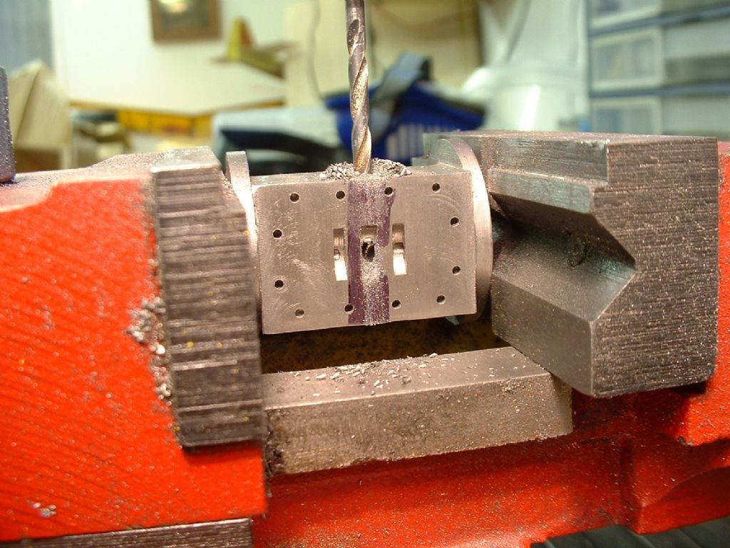

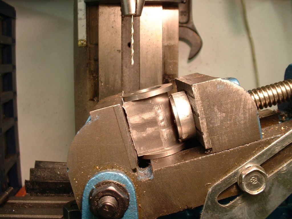

I used a milling vice to hold the cylinder (protected by aluminium slips) and used a 1/8" FC3 cutter to mill the 3/32" deep recesses at each end of the cylinder. I then used a tilting vice to hold it an angle to drill the steam passages number 53. I marked the position of the upper valve port on the side of the cylinder in pencil, and repeatedly moved the tip of the drill from in the recess to alongside the cylinder to ensure that it would break out into the port without damaging the face. It is essential that the drill neatly enters the corner of the recess for this to be successful. If you feed too fast or the drill is out of line when it starts, it will wander and could either snap, miss the port or, worst of all, emerge in the port face. I used a depth stop on the mill, and as you can see in the photograph, the drill neatly entered one side of the port. Without altering the angle of the vice I inverted the cylinder and drilled the other steam passage.
This is a rather nerve-racking procedure. Try to err on the side of drilling at too shallow an angle, as if you miss the port you can ‘poke’ a 1/16" drill into the bottom of each port to link it to he passage. If you use an end mill to create your ports, you can make them a little deeper and the job becomes less critical - you can make a wooden 'cradle' to hold the cylinder for drilling as you won’t need to make small adjustments to the angle.
Stub Mandrel23/01/2010 20:15:21
avatar
4318 forum posts
291 photos
1 articles
The final task at this stage was to drill the exhaust port, a less critical operation, as all I had to do is drill parallel to the valve face and avoid breaking into the cylinder bore. The only danger is breaking the drill as it emerges into the port.
