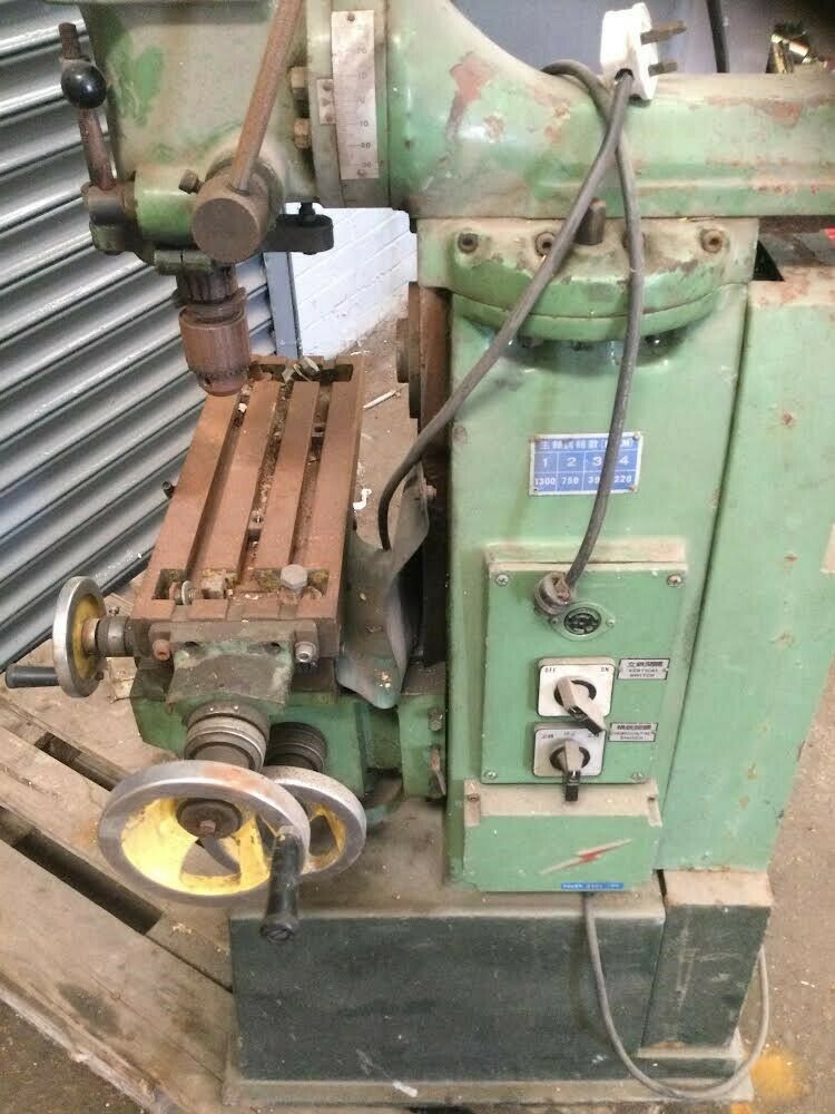

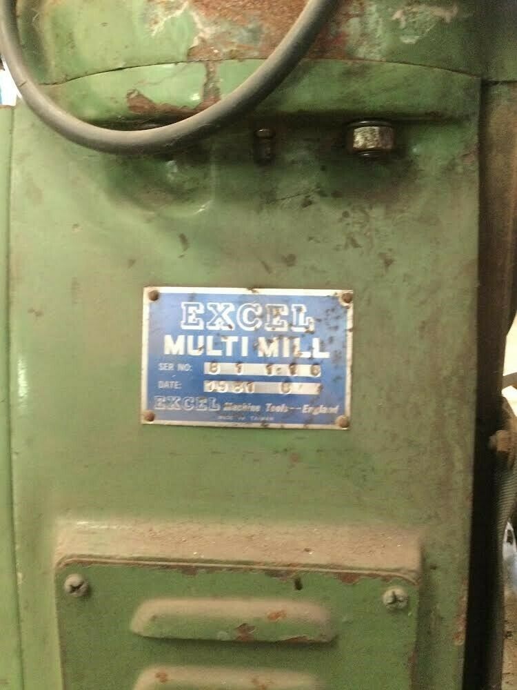

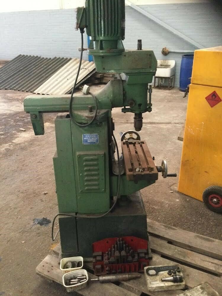

Please excuse the low quality eBay pictures but I have just purchased this machine and had to partially dismantle it to get it home so until it's back together it's the best I have got at the moment.
I took a bit of a punt on this machine on eBay as the pictures/description were poor but I also couldn't find any information online about this machine, I was able to find only 1 average image online.
So was wondering if any of the members have seen or own one of these machines before? What little I know about it so far are that it is made in Taiwan in 1981, has a int/iso 30 taper in both the vertical and horizontal spindles. It does have an "Alpine" sticker on one of the belt covers as well as the Excel tag on the machine. The turret is swung through 180 degrees to switch between vertical and horizontal mode. The vertical head has a quill that is currently seized (I believe the clamp is just rusted in he locked position). It does have a knee actuated by a handwheel underneath the table.
If anybody has any information or experience of these machines I would be interested to hear as it appears to be quite a versatile machine that is quite stout for its size but I was surprised to find no information online about it.
Thanks, Craig

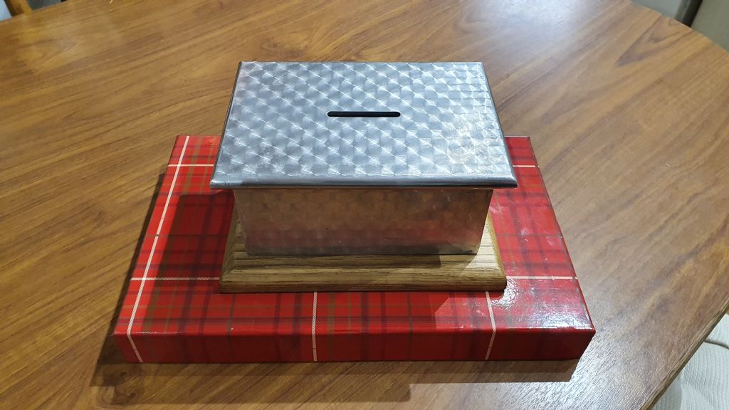

I made this money box for my son and basically used the exact same technique described by Jim above. A wooden dowel with a piece of leather glued to the end and used a mix of oil and surface grinder swarf as the abrasive. Cover the surface in oil and then sprinkle a small covering of the abrasive and then just work your way across. It's best to set up a fence to keep the pattern square and I just did my overlaps by eye. Obviously a spacer is then used between the part and the fence for the next row and so on and so on.
Craig
