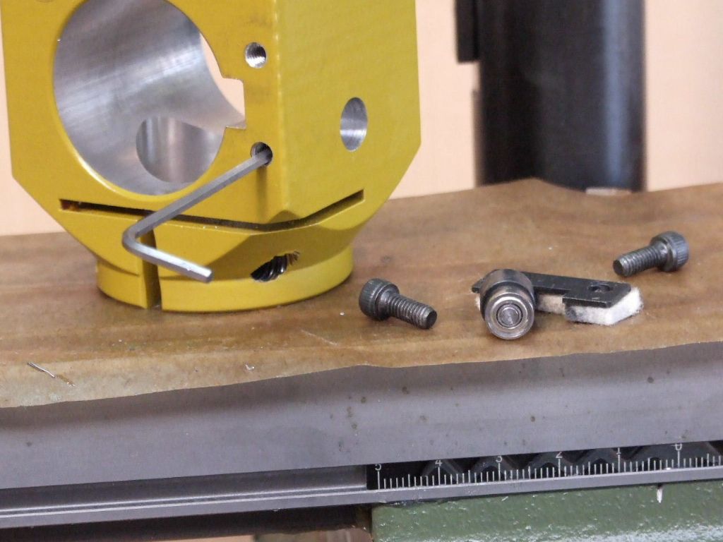

These are the adjuster parts and wiper assembly to keep swarf out. The Allen key is in an M4 grubscrew which locks the eccentric adjuster via a copper pad.

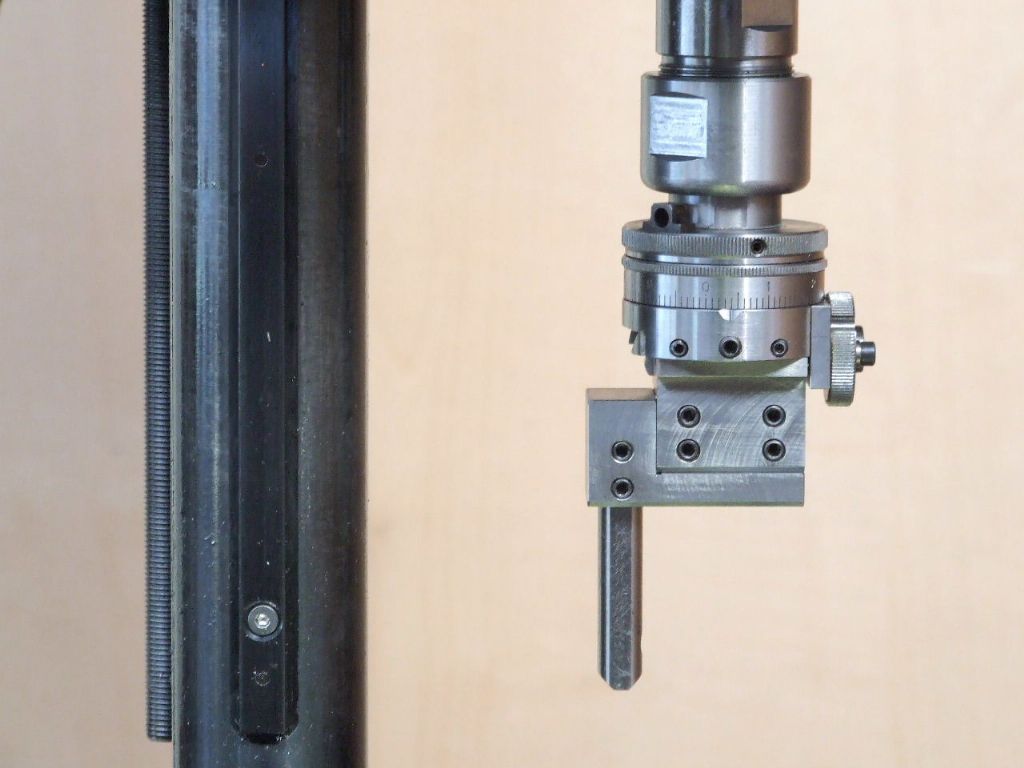

A while back in this thread I had to use my smaller Boring head to extend the range of my Boring and Facing head. A set-up which I was not impressed with, but it did do the job. I have since made a dedicated Extender block for the B&F Head, shown above.
Those Eagle Eyed among you might notice the two dowels in the Gib strip. This forms part of a further refinement for this machine and I will shortly post more details about this.
Regards
