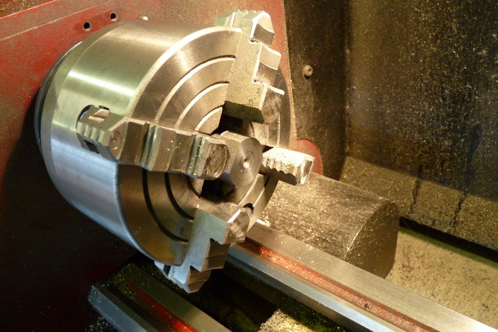

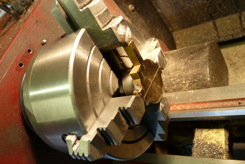

Thread: WARCO WM-250 lathe family and WM16 mill
01/01/2016 01:59:56
HAPPY NEW YEAR.
To finish 2015 off I managed to finally get the new QCTP fitted to my lathe.
Cut up a length of BMS, no bandsaw required here just a bit of old school elbow grease! smiley
Turned down to 22mm, 10mm hole drilled and a 6.7mm hole drilled further up the piece for a 8mm tap.
6.7mm tapped with M8 tap to fit existing stud on topslide.
Work piece fitted to stud to check for fit.
Piece parted off and turned down to 10mm for 1.5mm pitch thread.
The next steps was a baptism of fire! I installed my 4 jaw chuck and placed the round splined Turret body of the new QCTP in the jaws using copper pieces to protect the splines.
I used the inside diameter on the turret to align it in the 4 Jaw Chuck. Fortunately I watched this Youtube video so the process was not to painful:
https://youtu.be/2KMhx4DbyDg?list=PLK1rceD0kKIhofLeXXSjU7Qn6fipJOgvA
I had to then make some shims up for a 8mm boring bar to get work on centre. I set my boring bar 42mm out of the tool post but after a single pass it was clear that I would have to reduce the amount of overhang as the bar was deflecting in the bore.
This was a laborious task and took up much of the day as I had to bore 1 side of the the Turret turn the work around realign and bore out the other side.
Once complete the result was spot on and very pleased that I can now take advantage of the benefits a QCTP has to offer!

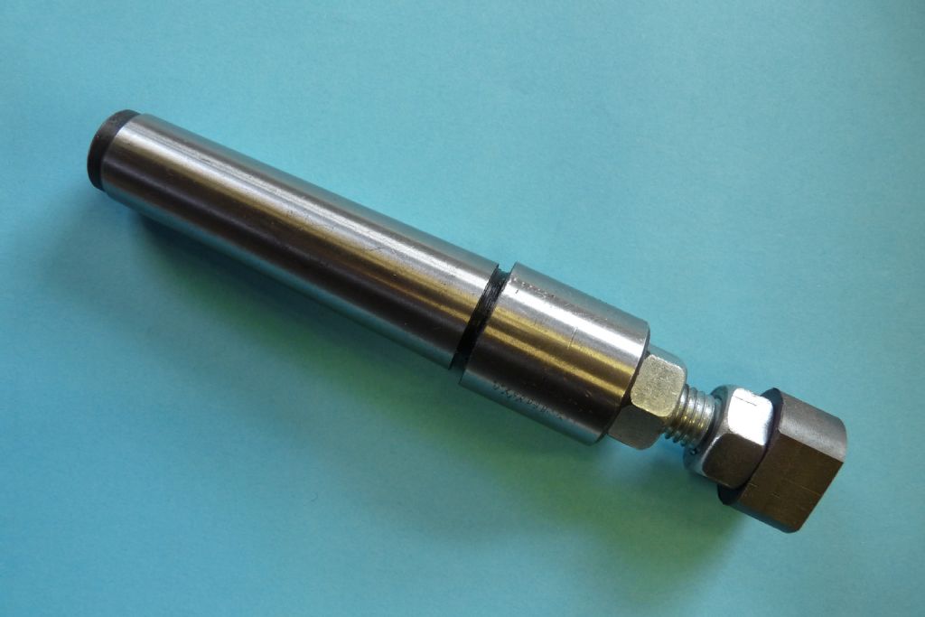

13/12/2015 11:28:11
Posted by Steve Withnell on 07/12/2015 19:48:00:
Using the headstock taper? Hmmm - how about this?
Used like this as a back stop -
For thin stuff -
Well that's another short article for Neil blown!
Regards
Steve
I love reading threads on this forum. Everyday is a schoolday! Steve thats really practical and nice idea. Is that a Mill MT Taper with your little mod applied to it?
TIA.
Grant
