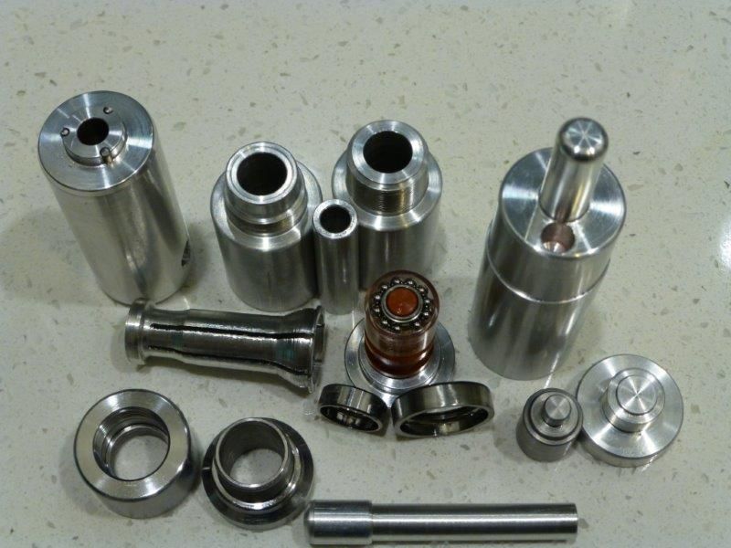

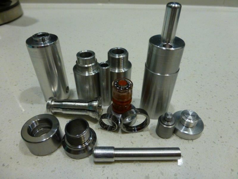

The tools to assemble the bearings with and the to get the front inner assembly together etc.
You can see the rear bearing puller and the assembled front inner race in the clear assembly housing. The hollow aluminium bar in the centre at the bottom, pushed the inner race and it's compliment of balls into the front outer race.

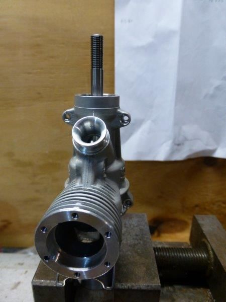

This is the crank and modified outer race assembled with ceramic balls in place, awaiting the heated case to be placed over the assembly. It is the easiest way to get the rear outer bearing shell into the case.
And when the case has been assembled.
Care has to be taken as if the shaft moves back in the case a few mm, the balls will fall out.

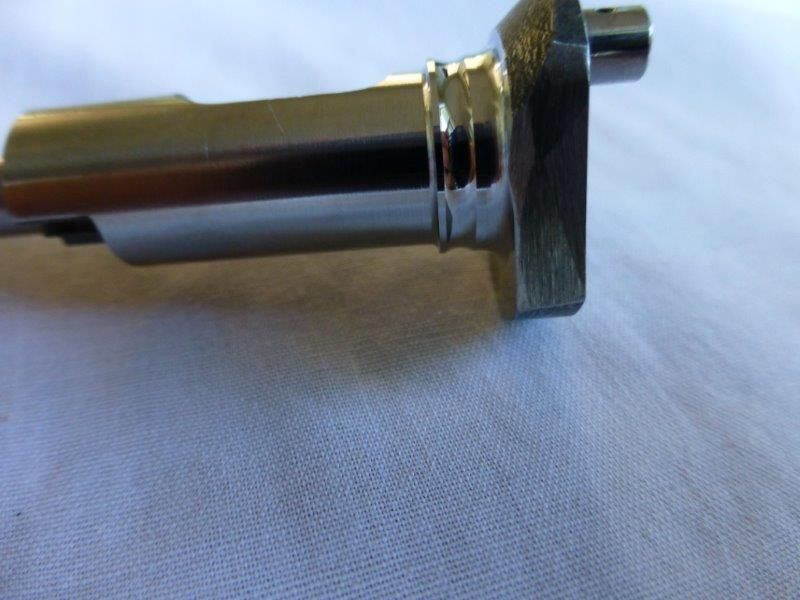

Crankshaft polished with balsawood mounted onto 1/8 shaft and 3000 grit diamond paste. These cranks have the inner race as part of the crank shaft, also know as an integral bearing crank.

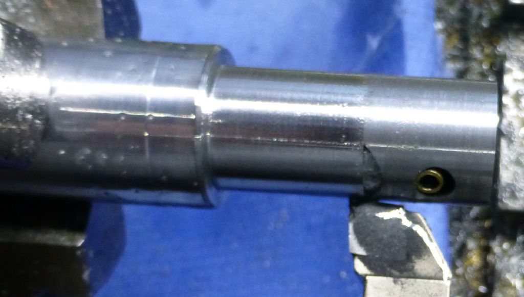

Fixture and Modified 6X15 outer shell. Turned using Kyocera insert ccgt060202mp-ck pr1425 on a 10mm shank boring bar at 500 rpm 0.1mm cuts 0.2mm diameter at a time.

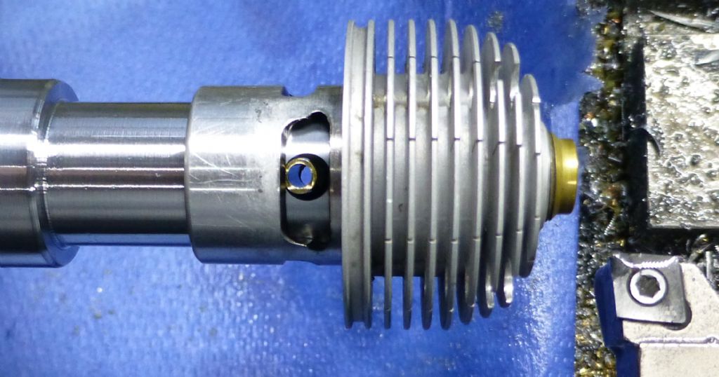

Here is a piston I am trimming for a friends model diesel engine, 2.5cc
I set the compound over to about 0.75 deg, it is actually at an angle so that
every 0.04mm that the compound moves backwards is 0.001mm diameter cut.
With a dti it is set at 0.05mm per 40 mm travel.
One picture shows the colour change with a 0.003mm diameter cut and the other shows the liner at it's
fitted position and the oil colour change for the amount taken off to fit the piston 0.5 mm more up the bore.
The bore taper is about 0.00061mm per 1mm of travel, so about Ø 0.0012 per 1mm travel.
Measured taper is Ø 0.012 for 10mm
