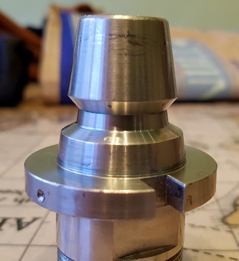

The balls locate in the groove near the bottom of the taper, as evidenced by the indentations! Surprisingly both flanks seem to be engaged by the balls.
Edited By Andrew Entwistle on 17/03/2021 18:26:24
17/03/2021 16:34:28
The Coventry type system is also available for slightly less from engineeringsupplies.co.uk. I tried making an ER25 holder from 304 stainless, but although it was made accurately, it soon developed runout because of indentations in the taper from the locking balls. It would need to be hardened at least in that region to be successful.
Andrew.
