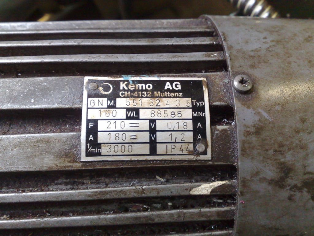

Thanks for the replies everyone. I have contacted lenze via email and requested a manual, hopefully they will have one on pdf. The fact there is nothing obviously charred is confusing to me too, but as someone said the machine is from 1981/82 so something is getting tired. With the brief bit of research i have done on this board, it appears to have been around for a long time and been used widely, so it must be reasonably reliable. The motor is a swiss kemo unit, but there is no voltage info on it, just amperages.
24/03/2015 01:14:18
My tom senior mill has a dc motor with reduction gearbox at one end of the table to provide power feed in the x-axis. Ever since i bought the mill a few years ago, when using the power feed, especially with a heavy cut, there was a strong smell of something electrical burning and copious smoke from the electrical box on the base of the machine.
I know its nothing to do with the main motor drive as i removed the drive pcb to make room for a vfd to power the main motor. All i left was the pcb that powers the dc motor. I have examined the board and cannot see anything burnt, and i do not have access to a thermal imaging camera to see whats getting hot. The best thing i can do at this stage is buy a new dc board so i can once again use the power feed, getting tired cranking the handle.
Does anyone know of a company that makes or supplies drive boards for this type of application ?
