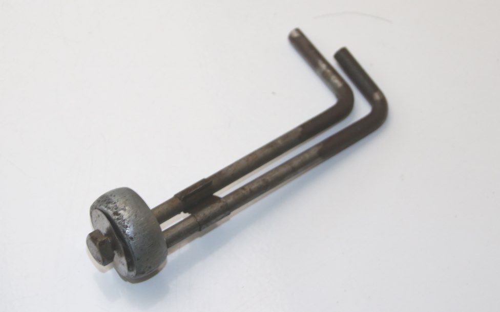

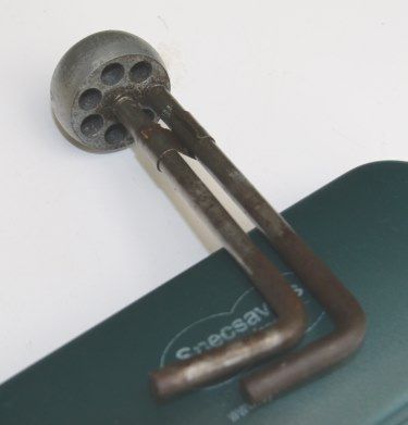

I have a Kennedy 60?(small one) Power hacksaw that is missing the oil damper parts, the two rods, disc and the valve plate.
Could any supply some pictures and dimensions of the missing parts ie length of rods, size of disc, number and size of holes in disc?
Thanks

Plunger is .258" dia. x .511" thick. The underside of plunger has a circular piece .006" shim held in place by a bolt / stud. The two "L" shaped rods are made from .250" dia. rod. The short one sticks out from the top of the plunger by 3.625" and the longer by 4.3125". The "L" shaped short bent bits are 1.625" and 1.250".

Thank you.
I can see what is missing.
