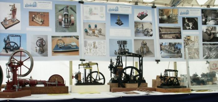

Why wait for them to offer it. Jo's kit of the Easton & Anderson Beam from Polly on the right and my doubled up one to its leftwink

That photo says it all Jason - and wouldn't it be great to be able to order x3 x4 !

Your lathe would need to be x3 and x4 too!
