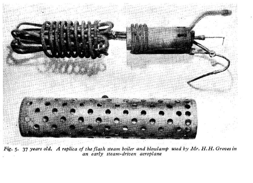

Ady123/03/2014 02:35:00
avatar
6137 forum posts
893 photos

I would guess that some means of atomising water from the supply side from the pump would make it easier and faster for converting water to steam...(surface area stuff)
Don't kno much about it at all though
