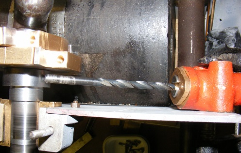

Is anyone building or has built the 3" Burrell to the Plastow design? My brother and I have been building this engine for the last year and up until now I/we have managed ok and made it up where there were no dimensions or wrong ones, of which there were a few.
the plans and castings are circa 1983 when they were bought secondhand.
The problem I have at the moment is fitting the water pump, the drawing dimensions are clearly wrong - or am I missing something? I have redrawn the pump, spectacle plates, eccentrics etc in ACAD and for the life of me I can't make it work. The pump clashes seriously with the second shaft tube. When I put it in different positions in CAD I get clashes with Conrod and spectacle plate and rear of piston.
I have searched the Internet and studied no end of pictures but the illusive one of the pump from directly above is just not out there. I want to know the following:-
Can anyone help with the position of the fixings for the pump or a picture of the pump from above.
Does the conrod have an offset in plan and in elevation?
Btw the pump is the original Plastow casting (picture below) there are more pictures in my albums.
if anyone can help it will be much appreciated
Best regards
Deric

And here is one from the first 3" Burrell build I came across on TT, looks like a straight rod on plan

Jason, can you point me towards (with a link maybe). I have registered with TT but I haven't recovered a message to activate my account. Weekend maybe? That picture is just what I want! And shows that the conrod will in fact have a set on it. The drill is pointing at the governor drive belt pulley the eccentric actually runs adjacent to the bearing a the bottom of the picture.

Thanks for you reply. What I'm looking for is a picture of the pump side on from the right and left hand sides. So that I can see the fixing bolts and the angle of the pump ram connecting rod. Also, regarding the bottom fixing bolt, where abouts is it in relation to the second shaft flange. I note that your pump ram has the connecting rod fixed at the top
l I have followed the original drawings which has the connecting rod fixed at the bottom inside the ram. I guess you have the new drawings?

I have added several more photos to the Burrell album hope they are of use to you, the new pump drawing show the con rod at the end of the ram, also the con rod as a .250" set in it and one more bit of info that may help you the top fixing hole for the my pump is approx 1" from the top of the horn plate and .500" in from the edge. I also checked my drawing and the pump fixing holes are not shown ! If I can be of further help let me know.

that was most useful, thank you very much. You pump is obviously not of the castings and we were wondering if you had fabricated it? It looks like you have had it off to modify it, what was reason for that?
we are back in the workshop today and are going to have go at that pump and get it fixed on the hornplate. I'll put some pictures in my album later.

Water pimp fittedGood evening Harry,
thank you again for your photos, they gave me the confidence to tackle my pump.
We fitted it yesterday and all went well. I have put some pictures of the progress so far in the album.
