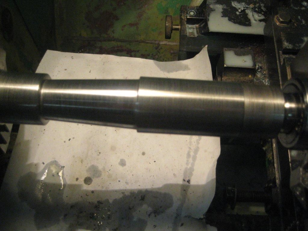

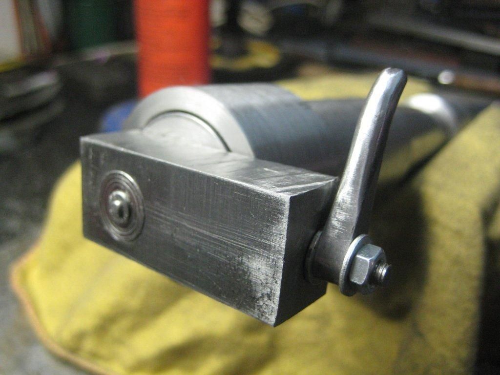

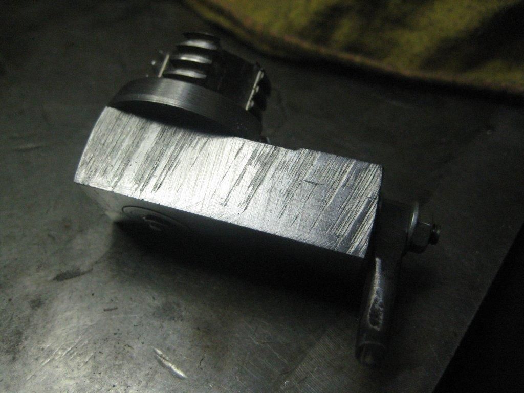

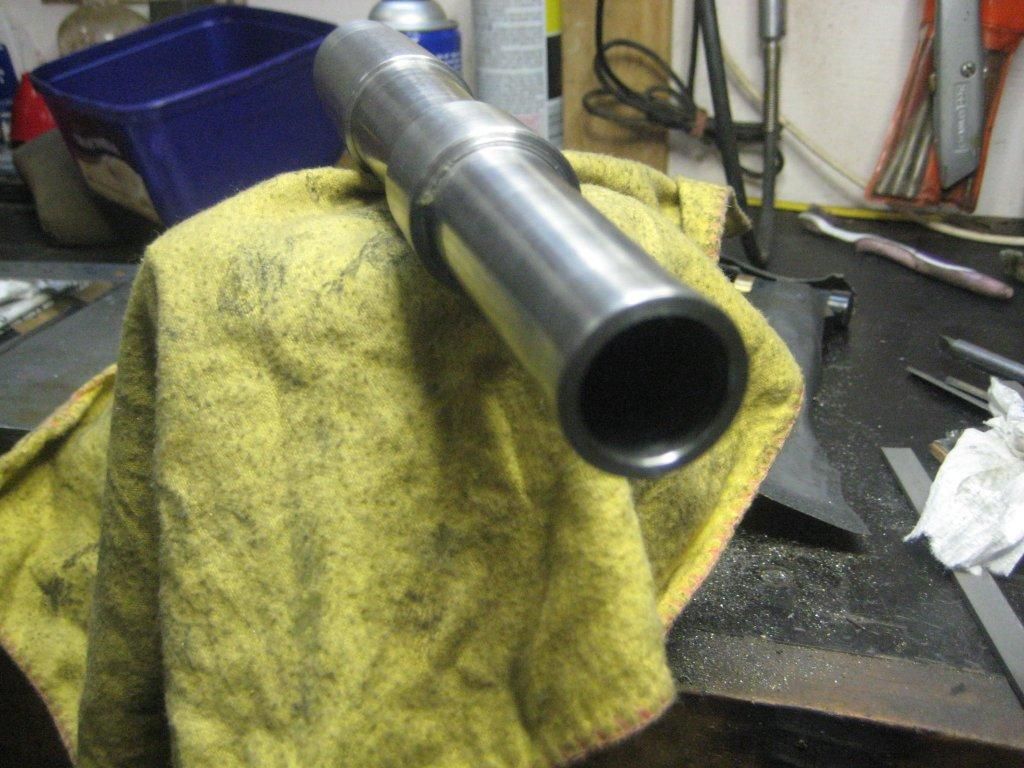

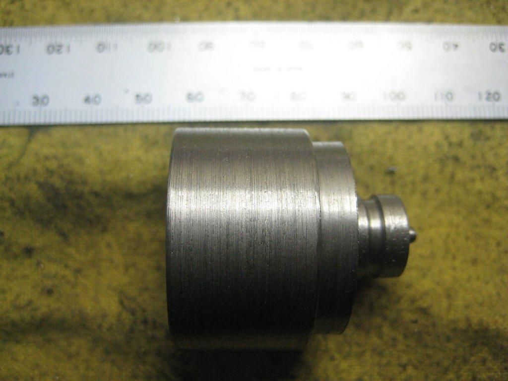

Barrel boring. There will be a rifled insert as the real thing.
Edited By bob gould on 20/04/2013 22:35:29
bob gould20/04/2013 23:46:31
75 forum posts
165 photos

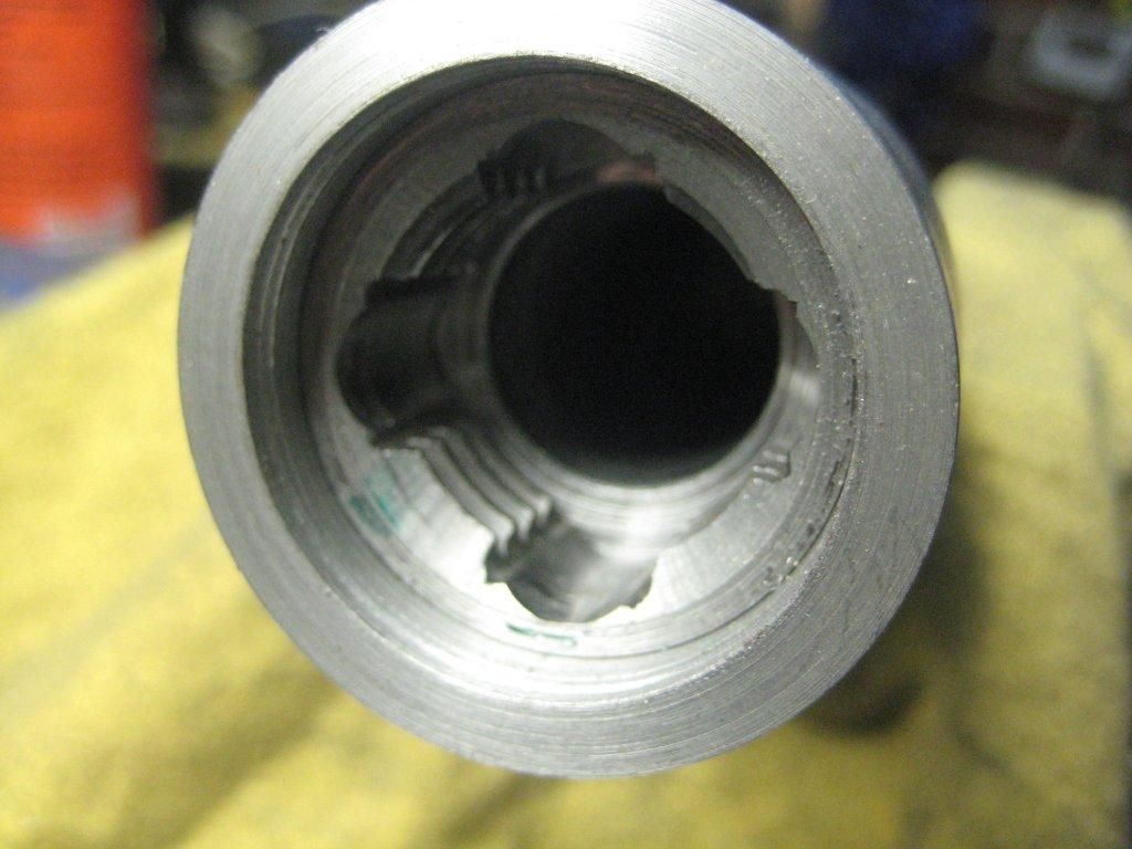

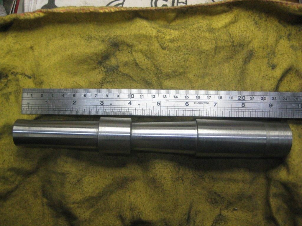

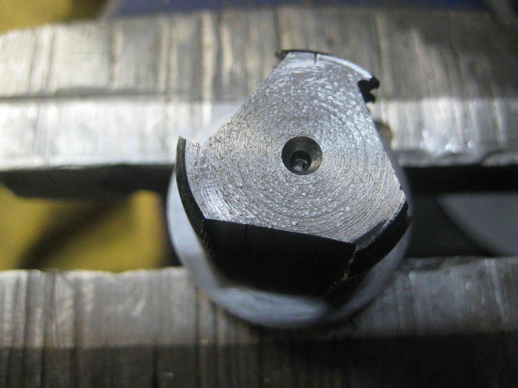

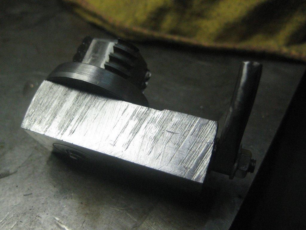

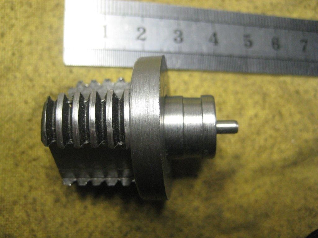

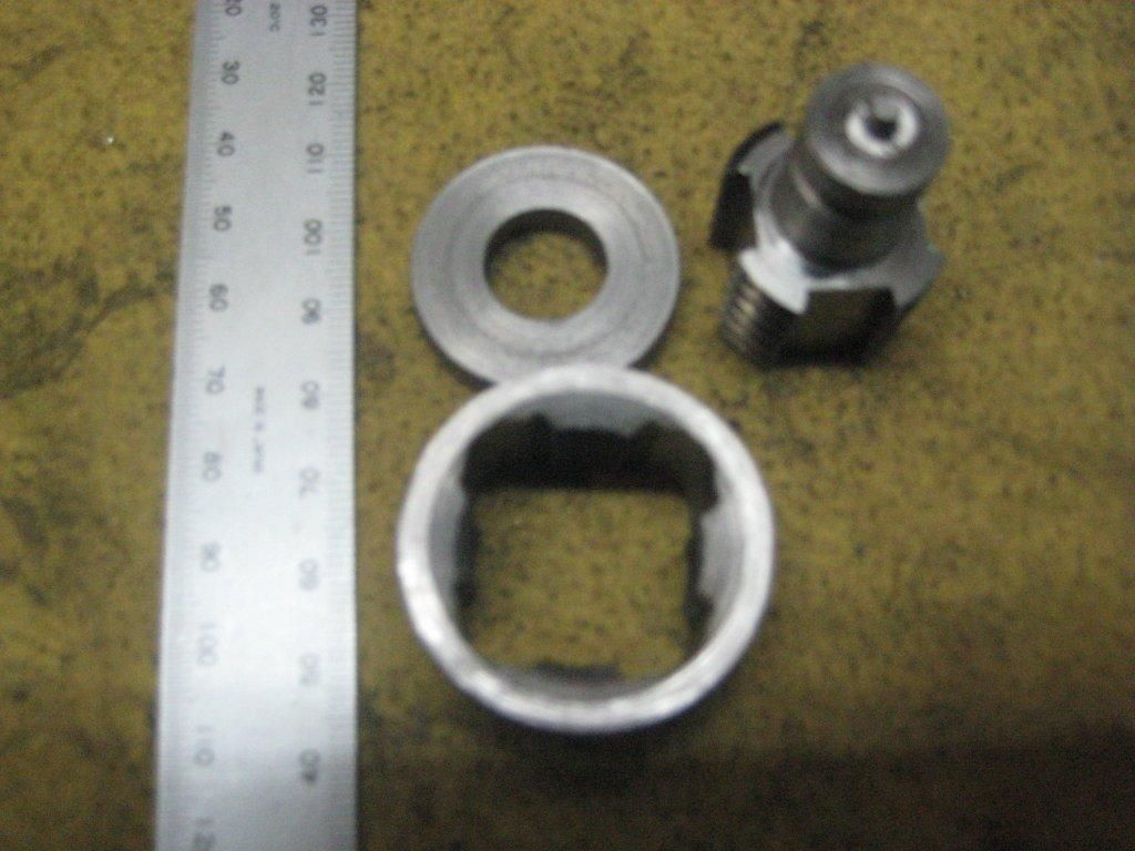

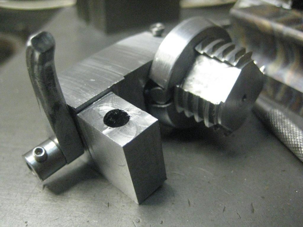

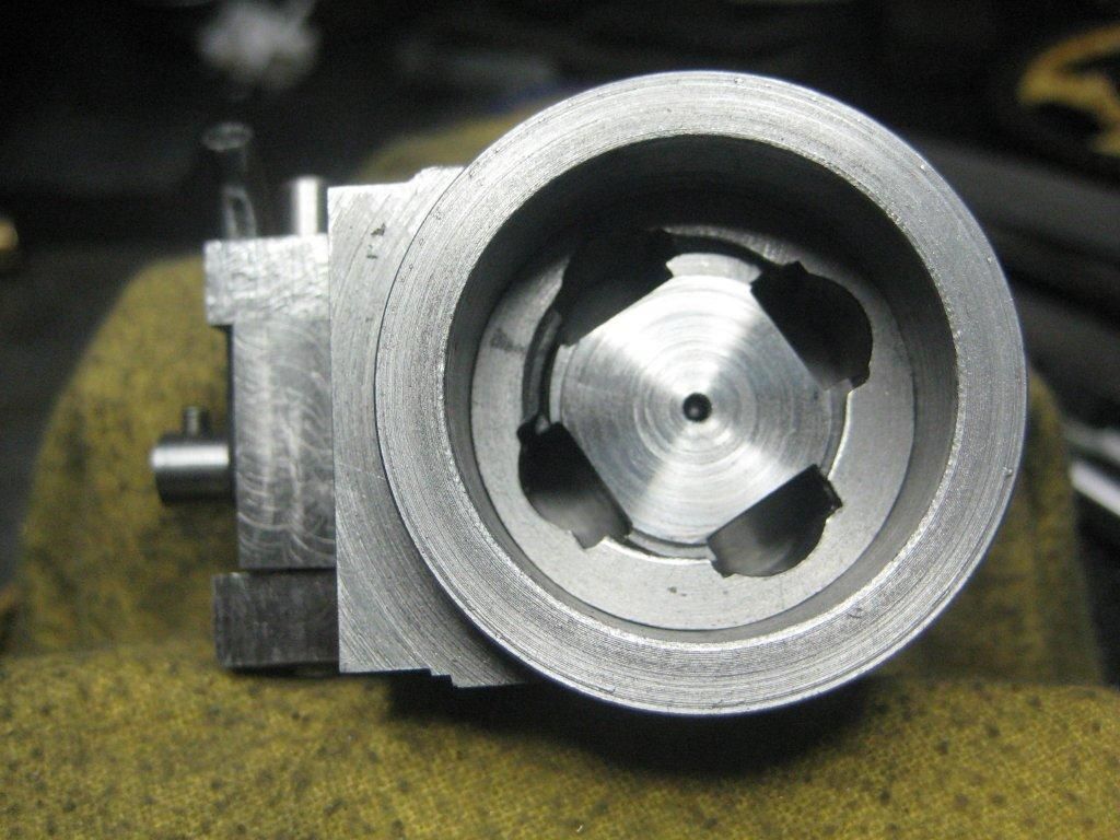

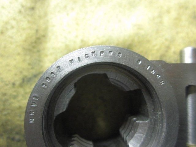

The breech operating shaft and cam requires a 45 deg turn but the first breech was a 3 segment which uses 60 deg turn to unlock. New breech block is 8 segment so it will only require a 45 deg turn.
1. assembly
2. parts

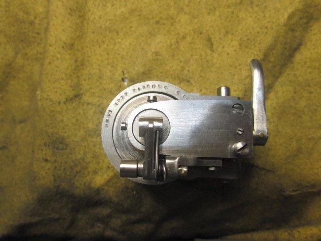

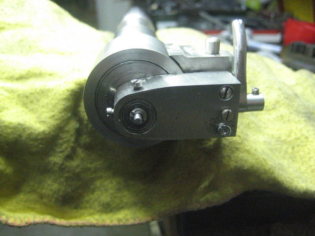

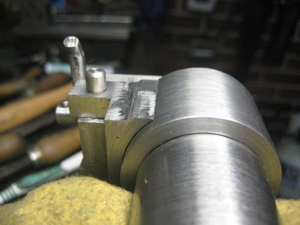

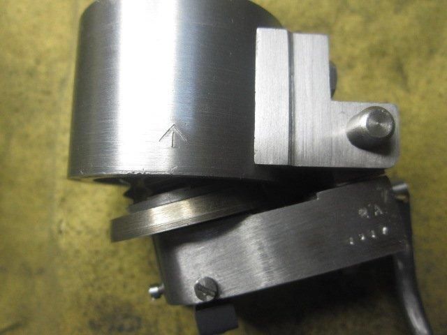

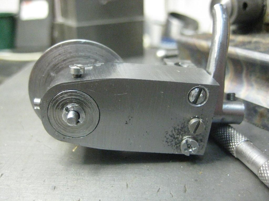

Breech testing. Finishing required
Breech housing
Breech assembly
Handle in open position
Handle in closed position

The following pics are of the working breech assy. It needs tyding up yet. The handle moves the cam which rotates the breech block, and the arm swings it away. Operation is smooth.
bob gould25/04/2013 18:14:41
75 forum posts
165 photos
functional
