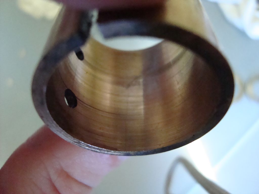

I noticed something today about my trusty ml2. When the belts are slack I read .001'' run out, now under tension the run out is .0005''. Can I asume my split bushings are worn guys? I am imagining the tension of the belt is wearing one side of the bushing more than the other?

Belt pull will affect the bearing loading, rather agreebly so it seems in your case, but as to bearing wear that would be a different matter. They are bound to 'ease' more on that side.
A test looking for movement in the mandrel when pulled hard back in a direction opposite to belt loading might be more indicative and then set the bearing nip accordingly to those findings.

Belt tension isn't the only force on the lathe mandrel. The reaction to the tool cutting force also tends to displace the mandrel in a direction depending on the headstock geometry.

Woody, are you saying there is up to 0.001" TIR on your spindle or are you saying there is up to 0.001" play? i.e.pushing and pulling with a clock in the bore and spindle at rest.
Two quite different things!
If it is play in the bearings I would suggest its nothing to worry about -- it will be taken up by the lubricating oil when the lathe is running. In Fact if there is no room for the oil you wil have all manner of problems with chatter etc.

Slow response sorry guys, Garrett turbo re-build, new roof on bungalow anyways back to machine's I am refering to ''play'' I have had a little fiddle after reading the comments about tension and more to note cutting forces. Pushing the spindle ''away'' horizontally toward the countershaft and also up vertically give the play. Guessing A bit of wear. I took a pic when I first had the lathe. As a novice I thought the scoring was a minor issue. I dont suffer with chatter though unless I take really deep cuts (+.005/.010 depending on material). The spindle is smoothe as. I'm learning the limits of the machine. Should I just buy something close and machine a new set guys? I did read simply maching a new set and replacing isn't possible. Seeming I had her for free I'm thinking just spend some cash. I hate made in china guys I really dont want to buy one!
Cheers.
David.
bush front

Have a go at a replacement set. You may surprise yourself
Do one bearing at a time, only one may need to be replaced to get her how you want
It's all part of the learning process
Alternatively, upgrade to a more professional machine, an ML2 was never meant to be anything more than a wee hobby unit

I think you are running away with the idea of replacing bearings quite needlessly. You seem hell bent on it.
The picture looked just fine to me, you say the spindle is in good shape so from my ML4 experience of many years ago just adjust the nip on the bearings to take up the trivial wear you have and it should be good for the next 50 years. Nothing more to do, start making things!
If you simply must spend money then buy a decent quality ML7 as a second machine
