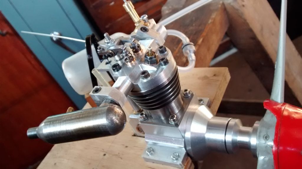

Mike Suffolk10/04/2014 17:00:39
8 forum posts
4 photos
Rod and Tom,
Thanks for your original posts which gave me confidence to get started, and also for the pointer to the Model Engine News site for the cam profile info.. My engine is now complete with maybe 30 minutes of running. Starts easily and purrs nicely. A lot to be said for the design I guess. I had no real problems with the build - just took it slow - the main problem was with my brain at times.
On a 12x5.5 prop I'm getting around 8500rpm which I'm very happy with and will be more than I need for what I have in mind.
Cheers,
Mike

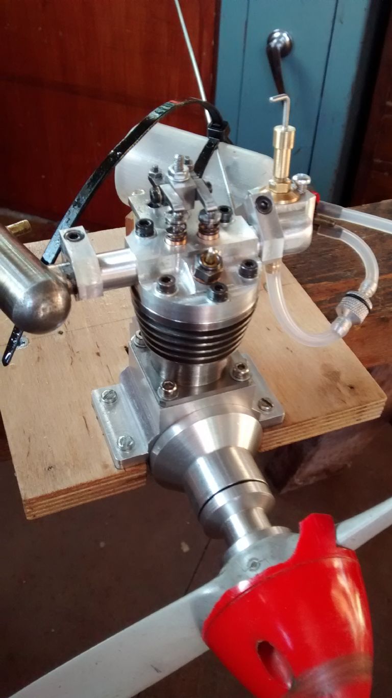

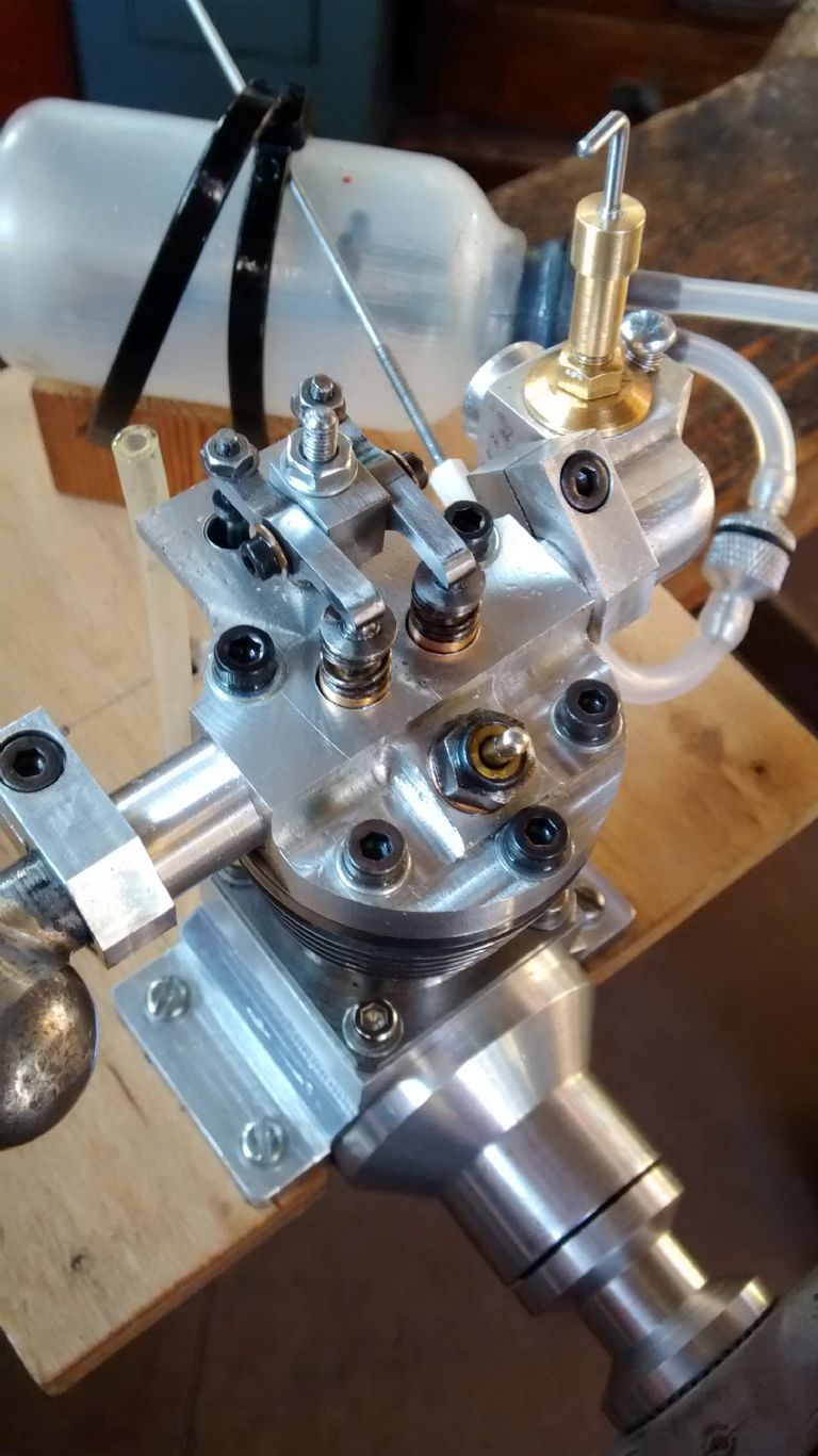

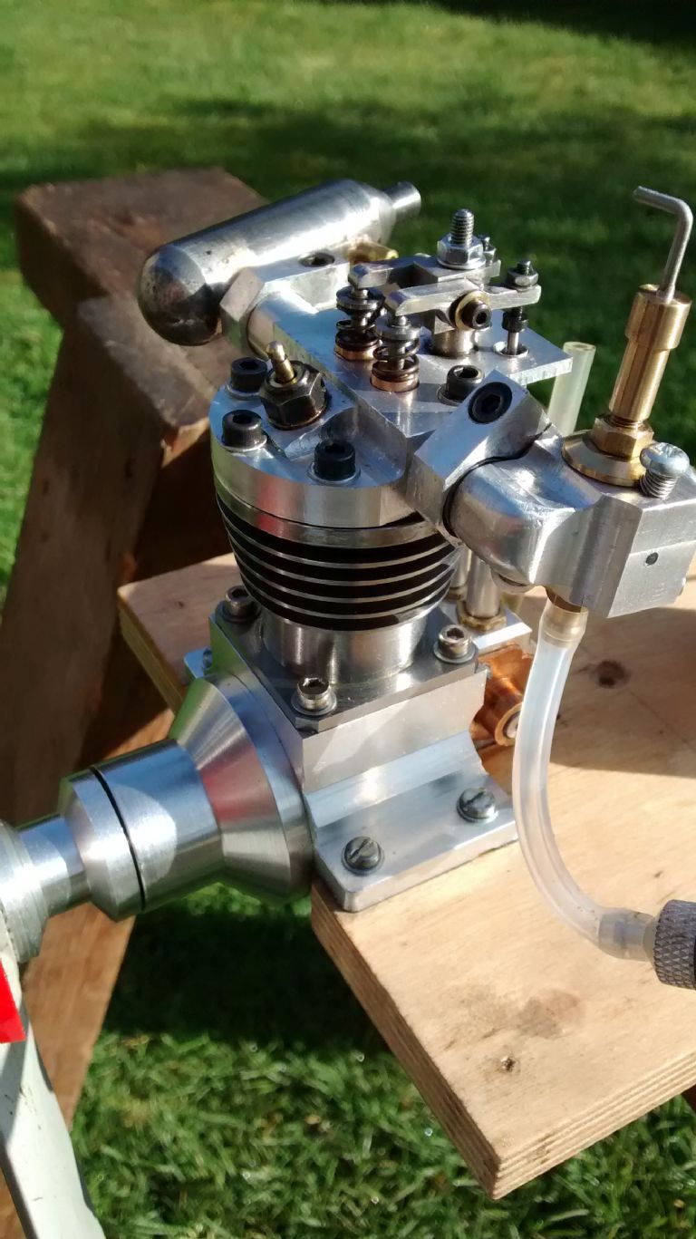

Mike Suffolk14/04/2014 19:15:41
8 forum posts
4 photos
Here are a few images Rod, not sure how to get a video in

Roderick Jenkins14/04/2014 23:36:26
avatar
2376 forum posts
800 photos
Mike, very nice indeed - much prettier than mine. I posted a video of my Wyvern by putting it on Youtube and then posting the link using the Youtube button in the reply box.
