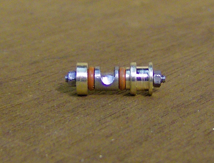

And the crankshaft with its unusual journals:
