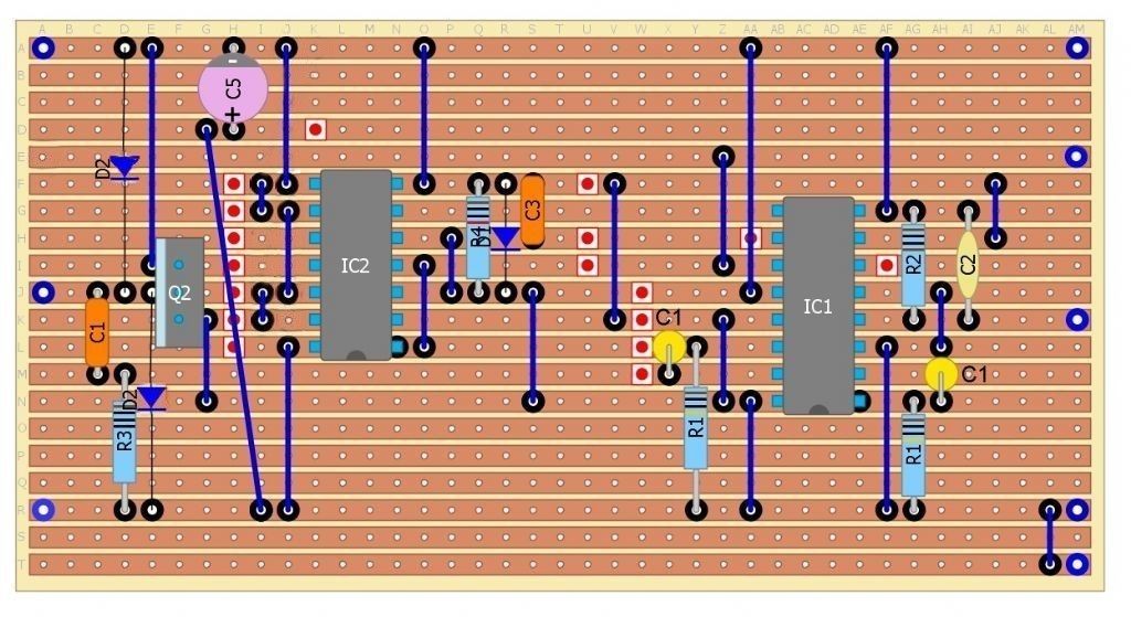

I'm having problems comming to grips with the electronics, as I feel some of the hole numbering are conflicting.
16 pin socket - 31:14, 31:7 & 27:7, 27:7 should this read 32:14. 32:7 & 27:14, 27:7?
Resistor 10K - 17:6, 17:10 - 17:10 is also the same as a link at 17:10?
Capacitor 0.01 - 16:6, 16:8 is also the same as a link at 16:8?
To cut track at 8:11 is also the same as link 8:11 does one cut the track at each side of the hole?
I would appreciate if anyone can advise me how I should proceed???

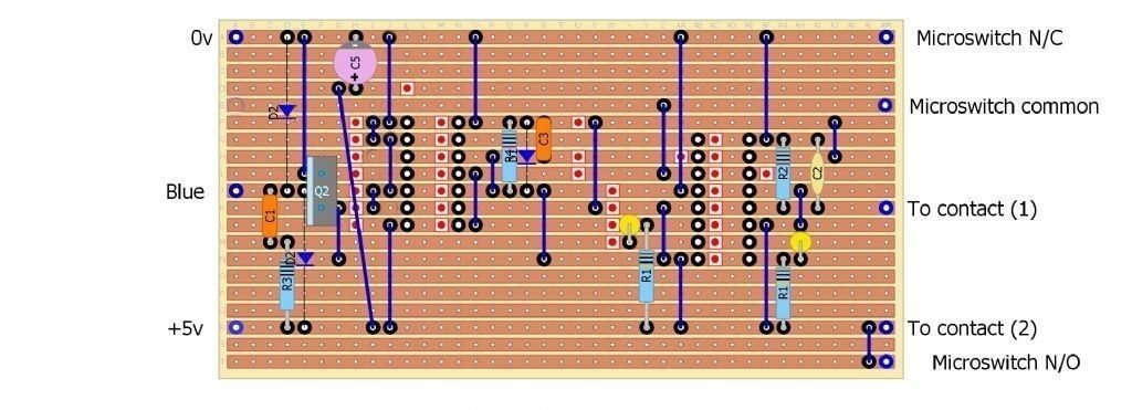

I had a bit of spare time today so i drew the board up for you i moved a few components to tidy the board up and to avoid the clashes with the hole numbering, if the posted images are not clear enough i can email a pdf of the images which is clearer
Regards
Dazz
dazz dazz14/11/2012 19:19:16
19 forum posts
9 photos
images are out of order grrrrr
Bottom one simply shows component placement
Second image is with the connections labled
First image is looking at the bottom of the board where you need to cut tracks
Third image is as if you were looking through the board from the top
This circuit was drawn from the articles doiwnloaded from this site (pdf 12) so may need tweaking if its been updated in a later edition
Regards
Dazz

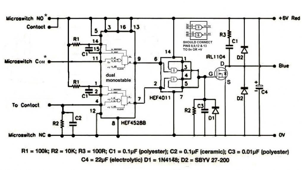

Hi Neal,
after downloading the pdf file12
I see the circuit shows the microswitch common terminal connected to +5V
instead of the 4528 input pin 11 (as shown the switch will short circuit the 5V supply)
another correction I'd make would be to connecting pins 8 , 9 12 & 13 of the 4011
to either 0V or +5V as the inputs of the unused Nand gates should not be left "floating" at an undefind logic level

dazz dazz15/11/2012 13:27:40
19 forum posts
9 photos
Hi Martin email on route
added two photos incorporating John Swift's suggestions

Hi Dazz
I've made two changes to you diagrams
first change to break the connection to the 4011 pin 10 (the output of a unused nand gate)
the second change is to connect the cathode of the two SBYV 27 -200 diodes to the positive
side of the circuit so they don't short circuit the 5V supply
Edited By john swift 1 on 15/11/2012 14:46:59
dazz dazz15/11/2012 15:47:23
19 forum posts
9 photos
Cheers John
i was looking at it and missed that one with the diodes many thanks for the correction
