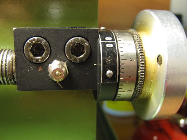

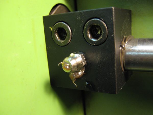

I have owned an EMCO Compact 8 lathe for almost 20 years and just recently I found that extensive cracks have developed in the lead screw mounts of the cross slide table and that of the compound. Has any Compact 8 owner experienced the same thing ?
Anyway, these two parts will need be replaced. I understand that the EMCO division making hobby machines is already out of business but is there any chance that some suppliers may still be carrying these parts ? Any information that will help to bring my compact 8 back to live again will be very much appreciated.

Very strange. I now have 2 Emco Compact 8s and both do not suffer the zinc/zamac issues you seem to have shown. Both have wear on the power drive idler pulley bearings, but nothing like you show. One is from 1976, the other from 1978, if I understand the serial number sequencing correctly.

Seems to be an affliction known as 'zinc pest' — see here:
**LINK**
Only similar thing I've seen is metal rot of the 'pot metal' gear wheels supplied with Atlas lathes.
I've sometimes fretted over the 'Mazak' elements of my 45-year old Myford ML10 but they'e in good nick apart from some wear of the crosslide leadscrew bracket journal (equivalent of the OP's part). Needs bushing. I only wish they hadn't used Mazak for the leadscrew half-nuts — currently, £66 a pop!

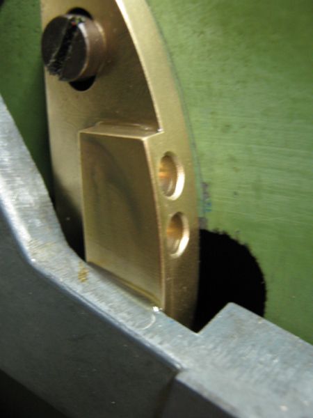

I am new to this site and came a cross the problems that are occurring to the die cast parts of Emco lathes .Owning a 8.6 myself for more than 37 years I did an inspection on all die cast parts and found several cracked ones.The two bearing blocks and the locking block from the tumbler gears.These parts are no longer available.The replacements I made are of solid bronze see pictures.There was want thing I noticed that only the parts that where market with something that looks like a little bear were cracked all others are fine.

img_3186.jpgSorry forgot the pictures

Frank; Nice work.

I just sprayed them black with some left over paint may not the best job,but needed my lathe to get up and ready
