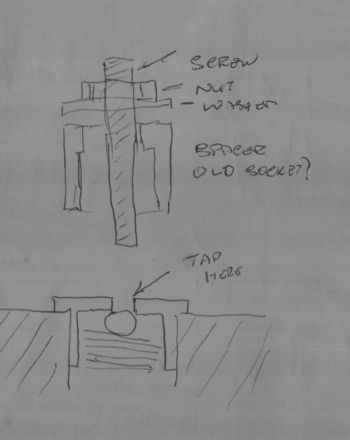

Remove the shaft then punch the ball and spring out thru the bottom.
Then tap the hole that's left, any suitable size and use a long screw with a packing piece, old socket works well and pull the old oiler body out.
In all fairness to Terry do not use this type of extractor as all they do is wind into the hole and expand the body so it jammed tight. For these taperered extractors to work the body would be that loose it fell out.

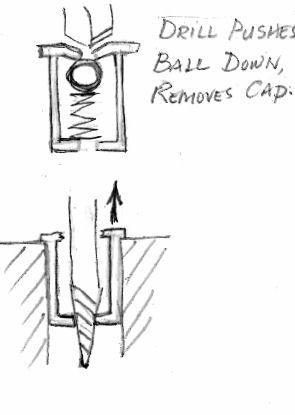

I did say a small extractor into the bottom hole. Perhaps I should have emphasised that I didn't mean using it into the external shell. I hvae seen the ball and spring removed from the top by drilling, our maintenance technician did it regularly - we had about 40 lathes, millers, drillers etc which needed these oilers replacing from time to time by drilling the top rather than punching through, there was a more substantial base left.
Interesting to see a different approach. The shells of the oilers we used didn't appear to be substantial enough to be tapped. One is never to old to learn.

No Terry i probably wasn't clear enough.
You punch the ball and spring out to make room then tap the top hole out which is smaller than the body.
Got to shoot out now, just done a quick sketch but the damn scanner wants updated drivers, will do it when I get back

Hi John,
The Oilers we had, had small bottom hole i.e. (not as rude as it sounds embarrassed)
Here's my sketch.  Don't blame me - you started this sketch thing wink 2
I see the advantage of your approach though and would recommend it.

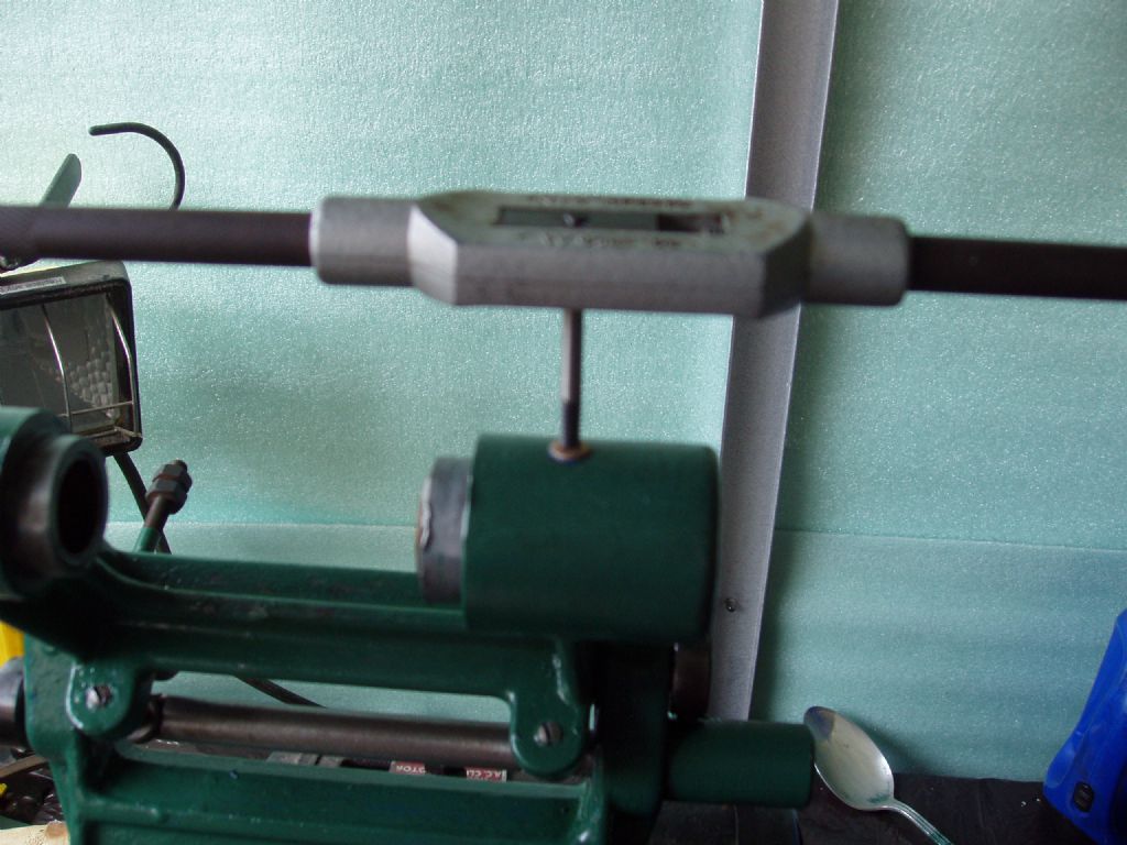

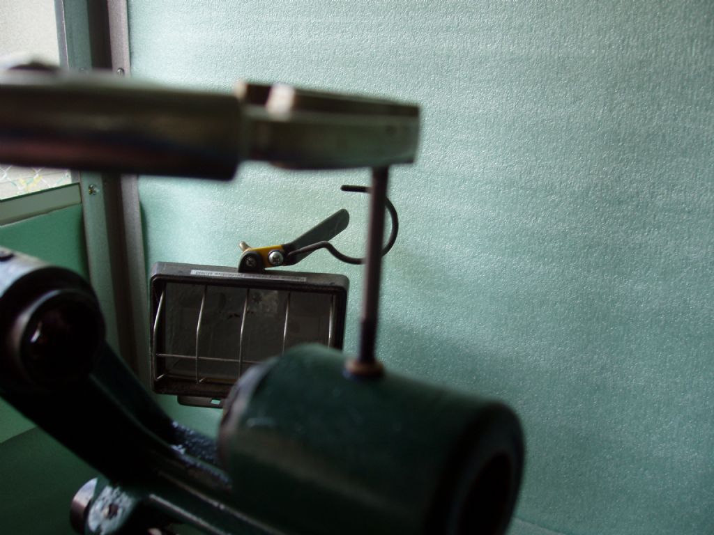

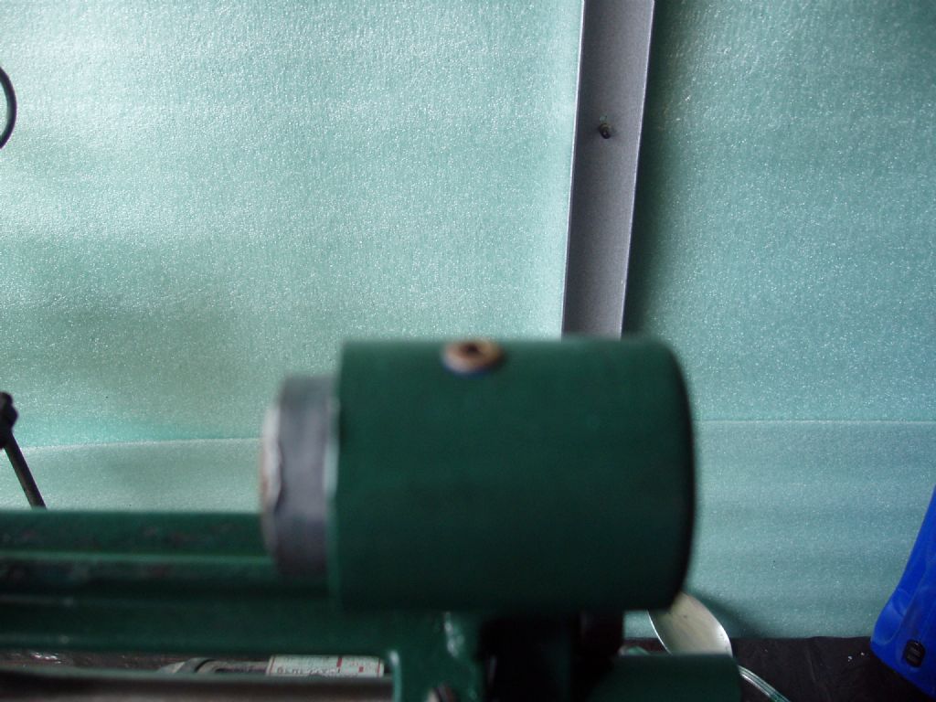

I have a couple of photos of how I did it. Don't know if it will help anybody, but it came out very easy. With the first oiler the ball was already out, thus the reason why I want to replace it. I tried to clean it and I pushed a bit too hard. With the second oiler I just tapped the ball down with an appropriate sized allen key.
To remove the oilers I turned the smallest extractor into the top hole, probably 5 to 6 turns and then used a vice grip (sorry, can't remember what you call it here, that's what we call it in South Africa), gripped it and tapped the bottom of the grips with a small rubber hammer. It came out as easy as pie.
Photos are a bit blurred, sorry.
