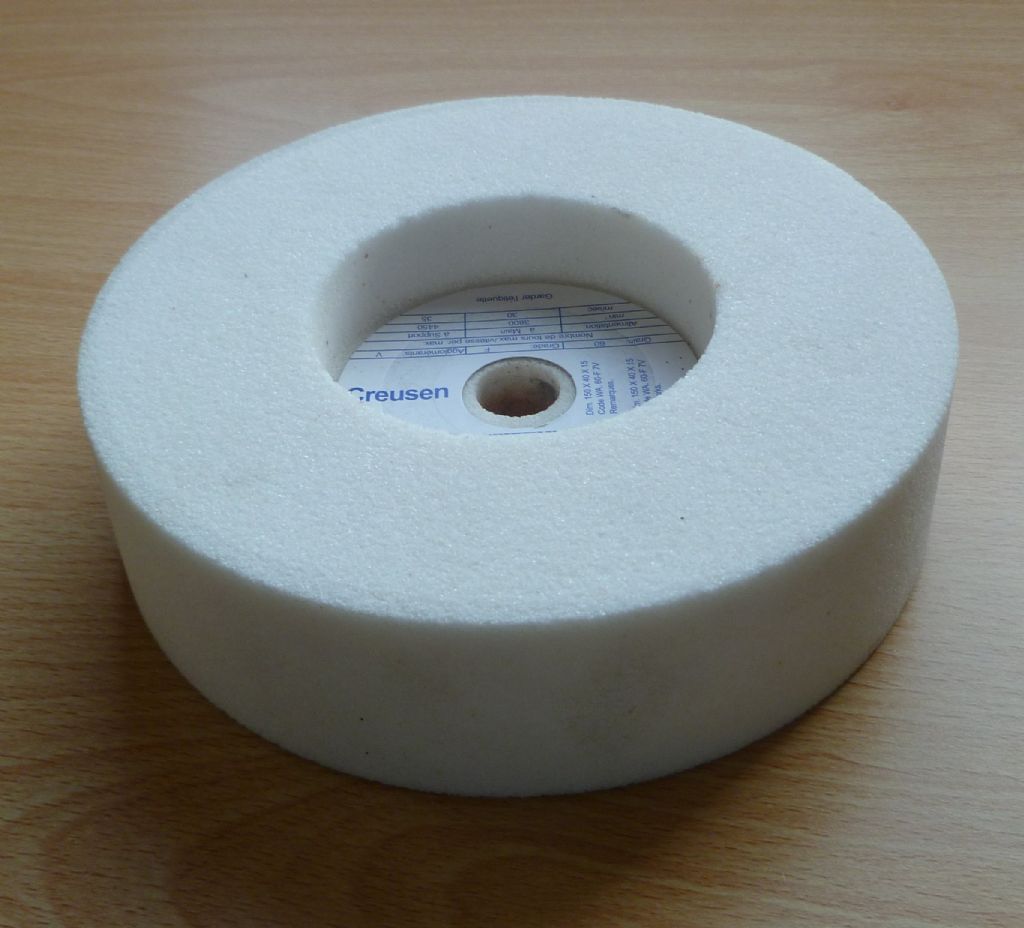

I have a small KEF bench grinder which runs at 3000rpm and has two general purpose grey 125 x 16 wide x 13mm bore wheels, one coarse and the other a bit finer.
I want to replace the coarser one with a very fine and soft wheel for hand grinding an almost ready-to-use finish on my small hss lathe tools.
Can anyone advise me as to the grade that I should get and where I could buy it? I guess that if the centre hole is oversize I can make up a pair of thick washers to fit the spindle. The grit size would be 100 or 120 but I don't know about the binder and modern materials.
It should be a cup wheel so that I can use the side, I think.
Thanks

Choice of grinding wheel A60K5V. 100 or 120 grit will probably be too fine.
Axminster power tools do a recessed wheel in 80 grit in their catalogue but I found they had 60 grit in stock when I visited them.

Try Abtec Stores on ebay. I bought some cup grinding wheels from them a few years ago and they seem to be OK

Hi Merlin, Abtec Stores also do a selection of ready made reducing bushes, see the link below.
**LINK**
In industry when buying wheels for small bench grinders, a good selection of these bushes often came with the wheel, all moulded together a bit like the plastic Airfix kits are.

If you just want the wheel for finishing, why not consider C.B.N.?
These "diamond wheels" are easily found on E-bay, not too expensive, and the vendor was quite
helpful when I asked for basic information. they are brilliant for finish.
Just worth a thought. Roy.
