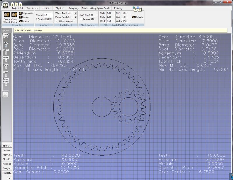

If you are talking 0.5 mod and an internal diameter, root in this case, of 20mm then you are looking at 42 teeth.
Right click and view image for a larger picture.
The tool used to form an internal gear, cannot be used for an external as the form is reversed.
One method of making one is to buy a small pinion say 15 tooth as in the picture, harden this grind the front face and holding this in the mill with the spindle locked use the quill as a vertical planer.
Work mounted on the rotary table underneath and feed in to depth, back out rotate the Rt by one tooth and start again. You may have to go a tad deeper to make up for the fact it will not generated the correct involute but it will be very close.
John S.

Great idea about the gearing from the screw driver. Funny enough I did find this idea via you tube whilst looking for planetary gears. I tried to find either Knackered screw drivers or actual parts and no joy.
The idea of using a pinion gear seems the best one so far. I do have one that fits the bill. You mentioned harden, do you mean a process to harden it some how. Is this heating and cooling it in engine oil? Also grinding, in what way? Is this the angle of the flat side at the intended cutting face?
I would like to know what software you used as above because it looks rather useful for me. Many thanks and I will post a thread about my progress.
