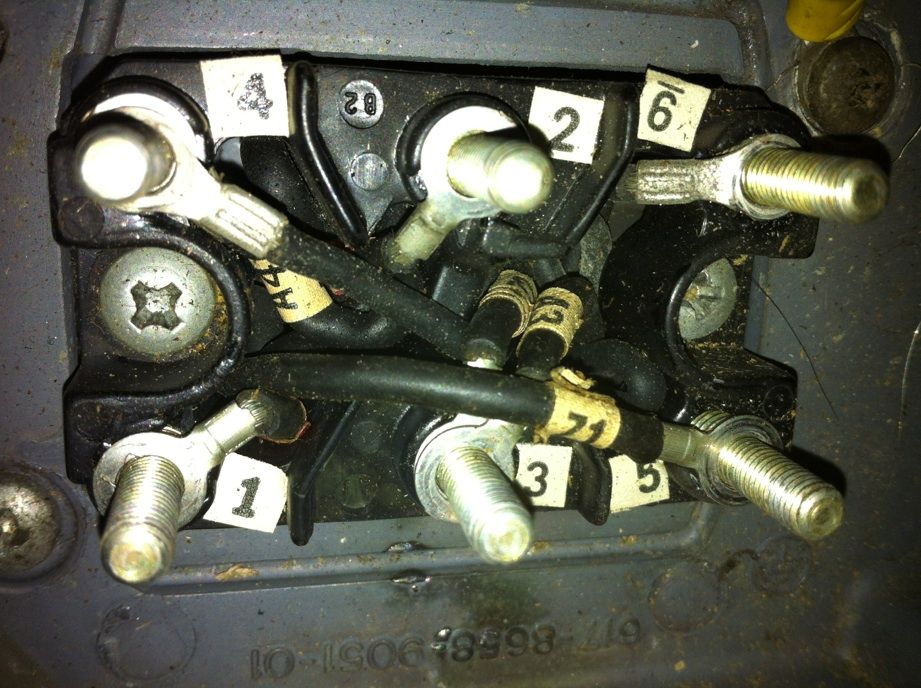

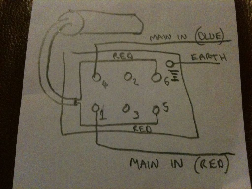

Leigh Davies24/02/2012 16:57:58
10 forum posts
6 photos
hi there again.
here is a photo of the control box.please can someone help ?
wiring for my motor in forward
Les Jones 124/02/2012 17:37:28
2292 forum posts
159 photos
Hi Leigh,
The cable going to the capacitor obscures most of the wires going to the inside of the motor and it also obscures what I think is terminal 2 (Middle top.) From the photograph I can only identify the label on one wire that goes into the motor. (Z1 to terminal 5)
1 How many wires go to the inside of the motor ?
2 Which terminal do these wires go to and what labels if any are on these wires ?
Les.
john fletcher 124/02/2012 17:51:16
893 forum posts
I have just looked in my garage at a similar motor with a not so different terminal box.I suggest you take a piece of paper and a pencil and make a sketch of the terminal box and note the colour and position of all the wires.It would appear that all you have to is move the links. Remove the incoming flat twin and earth, then move both link from the horizontal positions to vertical. Bottom left to top left and one I think link marked C to terminal above it.Next your input, and by the way you ought to using better or more appropriate cable with Green/yellow sleeve for the earth, connect supply to bottom left and the next terminal to it, marked C, I think. Well there you have it according the label on my motor. You can only blow the fuse if its wrong. If you lived close I would fix it for you, I've done lots in the pasted and have a good ohm meter to test out which winding is which, start or run. I notice its cap start which is good.Let me know how you get on, oh and by the way you need a double pole switch with centre off for reversing a single phase motor, not a dewhirst and use a starter with NO volt release for your own protection.Ted

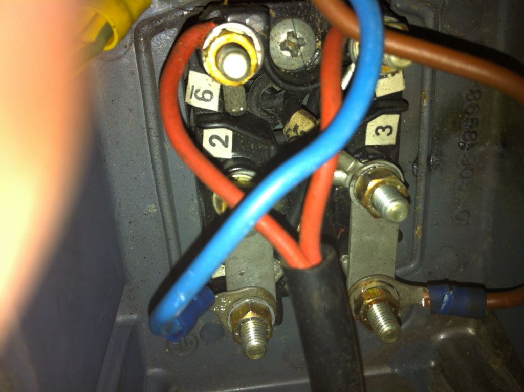

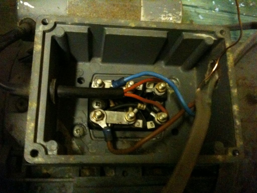

Leigh Davies24/02/2012 19:25:36
10 forum posts
6 photos
Leigh Davies24/02/2012 19:28:02
10 forum posts
6 photos
is this any help for photos.
Leigh Davies24/02/2012 19:29:59
10 forum posts
6 photos
i dont really know what the other wires go to without stripping the motor electric box off. sorry.
Les Jones 124/02/2012 20:35:19
2292 forum posts
159 photos
Hi Leigh,
I expected to see either 4 or 6 wires going to the inside of the motor depending on whether the start switch was connected internally or externaly to tha start winding. As there looks to be 8 wires coming out of the motor I have not worked out exactly how it is wired. I could probably work it out with a multimeter if I had access to the motor. I suspect John Fletcher 1's idea about moving the links is correct but I would not be prepared to try it without proving how the windings are connected to the terminals.
Les.

Russell Eberhardt25/02/2012 13:39:49
avatar
2785 forum posts
87 photos
The wires labelled Z1 and Z2 go to the start winding. To change the rotation direction you just need to swap these over. Usually this is done by moving the links for example like this: http://www.net-eng.co.uk/pdfs/Motors/single-phase-revers.pdf. However it looks to me as if your motor has had an external capacitor added to replace a faulty internal one and the wiring has been changed somewhat. If you can just swap the Z1 and Z2 connections it should work.
