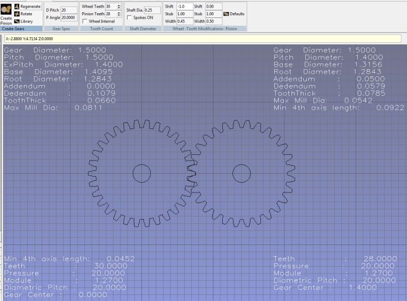

John Stevenson18/09/2011 09:18:09
avatar
5068 forum posts
3 photos
What DP are the gears ?
You can just get a 30T on a 28 blank, not a pretty tooth form but still an involute and workable.
This has been draw in in 20 DP just for reference, on the right is a big standard 28T gear, on the left is a corrected gear with 30 teeth on the same blank.
Click on picture to enlarge.
John S.

Anthony Rhodes18/09/2011 16:22:54
21 forum posts
31 photos
Posted by John Stevenson on 18/09/2011 09:18:09:
John S.
Edited By John Stevenson on 18/09/2011 09:18:57
John,
That was my first thought but it probably isn't necessary.
The inch version of the micrometer dial uses 36 DP gears. The first and last gears in the train are coaxial with the hand wheel shaft. Original train is 26/28 x 26/28. New train would be 28/28 x 26/30. Increases the radius occupied by the train by one tooth depth (0.027777777"). I expect it would fit within thedesign as is but I haven't actually checked.
Same story with the metric version which uses 40 DP gears. Original train is 29/31 x 29/31. New train would be 31/31 x 29/33. Again increases the radius occupied by one tooth depth (0.025").
There is some benefit for amateur construction to not have to deal with special form gears.
Anthony
