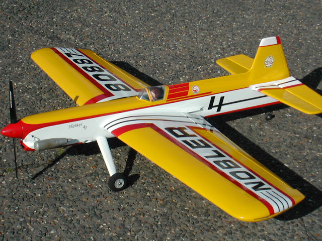

I'm reluctant to put a pic of model aircraft on here but as it's relevant to the topic I guess no one will mind too much
This is a 'Gieseke Nobler' model that was built around the mid nineties. It is covered in conventional Japanese tissue and painted with ordinary car cellulose which was readily available at the time and sealed with two pack clear coat. The masking took far longer than the actual painting. Yes its all masked and sprayed, lettering as well. The wingspan is 50 something inches maybe 52 certainly no more
Total all up weight as pictured was 42 ounces. That's reasonable for the size of model and the amount of paint! (The 42 on the nose is coincidental - that refers to the engine)
Masking on models is definitely done with finer tape than conventional DIY stuff. As you say Tamiya is about the best - that's readily available at a model shop. If anyone happens on any tan coloured BETTO masking tape that's even better - I'd like to know if you do as I haven't seen any for a while now.
As an addition to mgj's advice cut the tape thats going to mask the edge of the paint line as narrow as will take the masking 'blanket' eg newspaper or, even better, aluminium kitchen foil. This way the removal stresses on the paint below is kept to a minimum.
