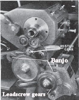

I am trying to set up Portass Model S lathe into working order and start using it. I find difficult to put together gear cogs that I would get at the end the thread I want. Does anybody have this lathe manual or more information and they do not mind to share it? Thank you

When you say 'thread' do you mean the leadscrew (along the front of the lathe which drives the saddle with the cutting tool?)
If so there should be a slotted bar on the end of the lathe where the gear train is.  This can be loosened and rotated with an idler gear attached which links the drive gears.  See the picture below, it's not very good but you can make out the slotted bar (often called a 'Banjo') with a large idler gear and the whole assembly has been adjusted so that the gears all mesh.   Note that the banjo on this lathe has two arms, some only have one.

The information we need is the pitch of the leadscrew and the gears in the changewheel set that you hopefully have. Some sets of changewheels go by steps of five, some by steps of four. Once we know what you have we can sort out a table, or if you are lucky someone might have one for that lathe.

It looks that I have not explained myself properly. Before I bought the lathe I saw the part on Lathes web. However it does not say which wheels were usually included with the lathe either metric or imperial. I have some gears which came with the lathe however I do not know if that is all set. What I know is that part of them is not from this lathe as they have different bore as well as two key-ways opposite each other. Perhaps from Atlas lathe.
I wanted to put together either whole set or to find how I can improvise those missing gears, how to use them for power feed and then learn how to make with them metric and imperial threads. I know that there are books for learning how to make threads and I will be purchasing them or if I find some local course open in the evenings that could be the way to do it. Hopefully this is better explanation.

Hi, I believe the Portass lathe had as standard change wheels from 20 up to 65 in 5 teeth stages i.e 20, 25, 30 ect. and I think the bores are 5/8 inch. The Portass S, Randa, Zyto, Bonds Maximus, were all much the same lathe. I'm not sure if they are able to cut metric theads without having a special change wheel or two. Hope this helps.

Thank you Nick and others. Just found from another source (Tony Griffiths) that there should be 2x20, 1x25,1x30,1x35, 1x40, 1x45,1x50,1x55,1x60. For metric conversion (usualy paid extra) there should be 1x 63 or 1x65. As I have checked I have most of them apart from metric conversions but those Atlas ones have one 63 slightly damaged (I will have to replace 2 teeth) with reduction inside I should be able to use it and rest hopefully will somewhere appear.
