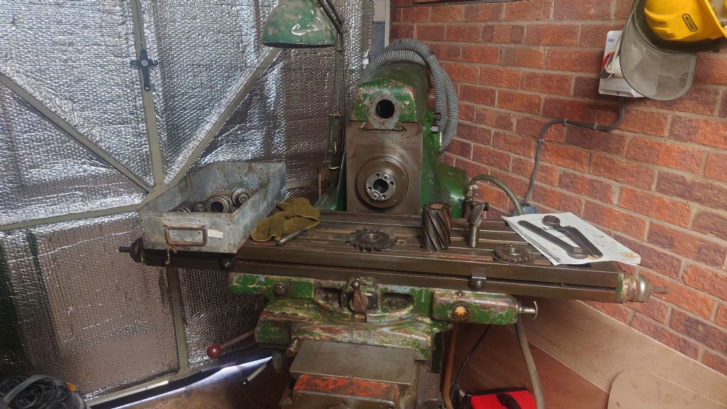

Rob Walker27/06/2023 09:09:17
8 forum posts
10 photos
Mill is a Victoria/Elliott U2 - 4HP.
A recent acquisition, a tool/project combo. She has been sat a while and needs a good overhaul to recommission to a fully serviceable condition. She runs nice and quietly in all gears and 2 out of 3 power feeds are functioning as they should. When I tested her at the sellers property it took a bit of tinkering to free off some of the feed controls and I'm hoping that once the feed control gearbox comes apart, the issue will be rectifiable.
Initial cleanup underway to see whats under the grime, initial inspections are encouraging.

Andrew Johnston27/06/2023 11:00:03
avatar
7061 forum posts
719 photos
Posted by Rob Walker on 27/06/2023 09:09:17:
That's a good solid mill, will have no problem driving slab mills. Universal as well, which is a nice feature to have, especially if you want to make helical gears.
Like Nigel I have a Clarkson T&C grinder with the accessories to sharpen slab mills and S&F cutters. Thus far I've never needed to use it, but the facility is there when I do.
With a horizantal mill you really need to understand the cutting forces and clamp the work accordingly. Slab mills and S&F cutters want to lift the work, especially with deeper cuts. I learnt the hard way that the laissez aller clamping methods I could get away with on the Bridgeport are nowhere near adequate for the horizontal mill.
Andrew

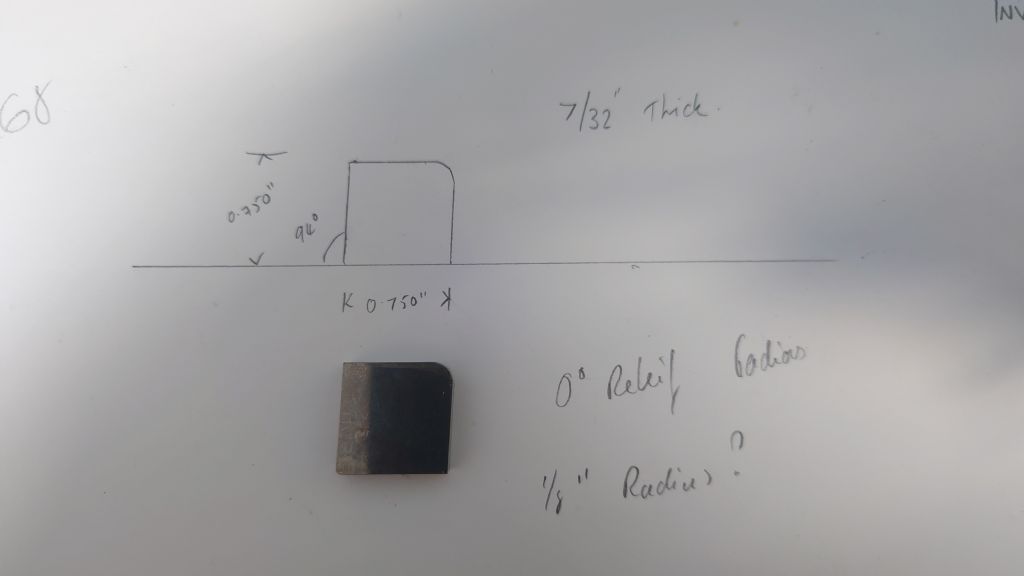

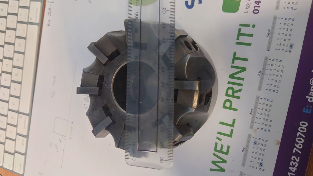

And if anyone can help identify these inserts and where I might get some more I would be grateful!...
Stueeee05/07/2023 16:42:20
avatar
144 forum posts
They look very similar to the inserts I use in a facemill here.
The same SNUN 1905xx inserts should fit -the 'ordinary' ones have a similar corner radius to yours. These, not so much...
**LINK**
The last time I looked, Jurassic tools had some SNUN 1905xx inserts for sale on their website (usual disclaimer, just a customer etc.)
Rob Walker06/07/2023 11:02:41
8 forum posts
10 photos
Posted by Stueeee on 05/07/2023 16:42:20:
**LINK**
Many thanks Stueeee, that's really helpful. Jurassic tools don't have any listed currently but their site is a new one to me and looks like a good place to keep an eye on. The Ebay ones will work for me, the radius is not important as the inserts are canted over in my holder and with luck I can get 4 edges from those, if I don't drive them too deep on each pass!
