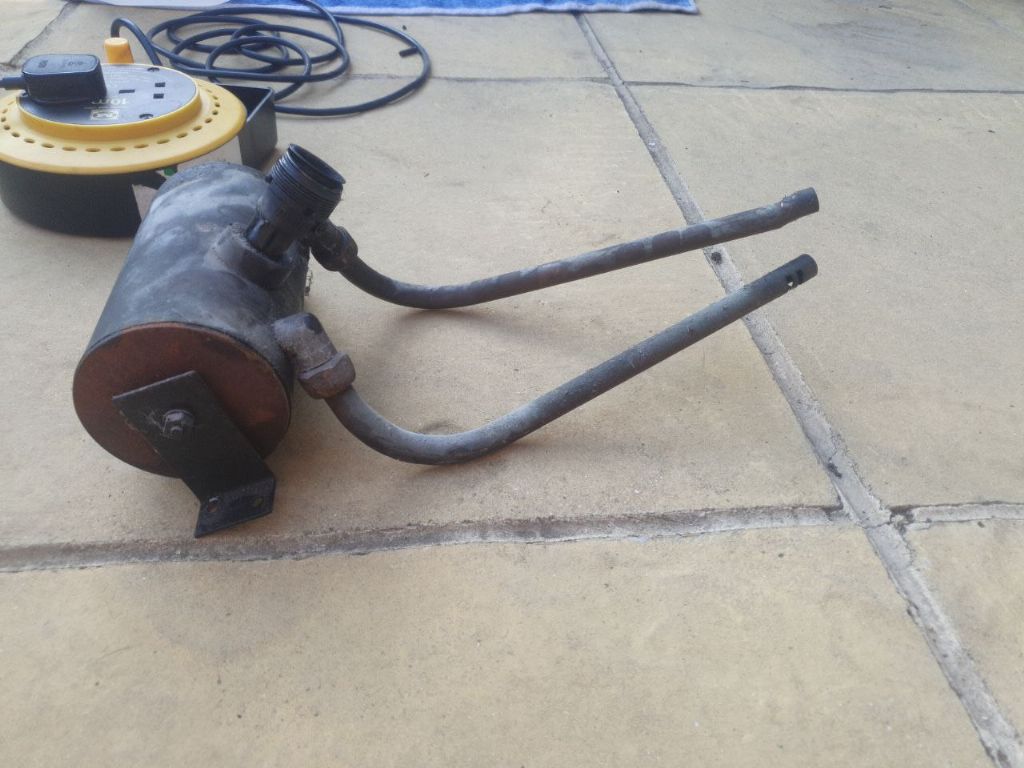

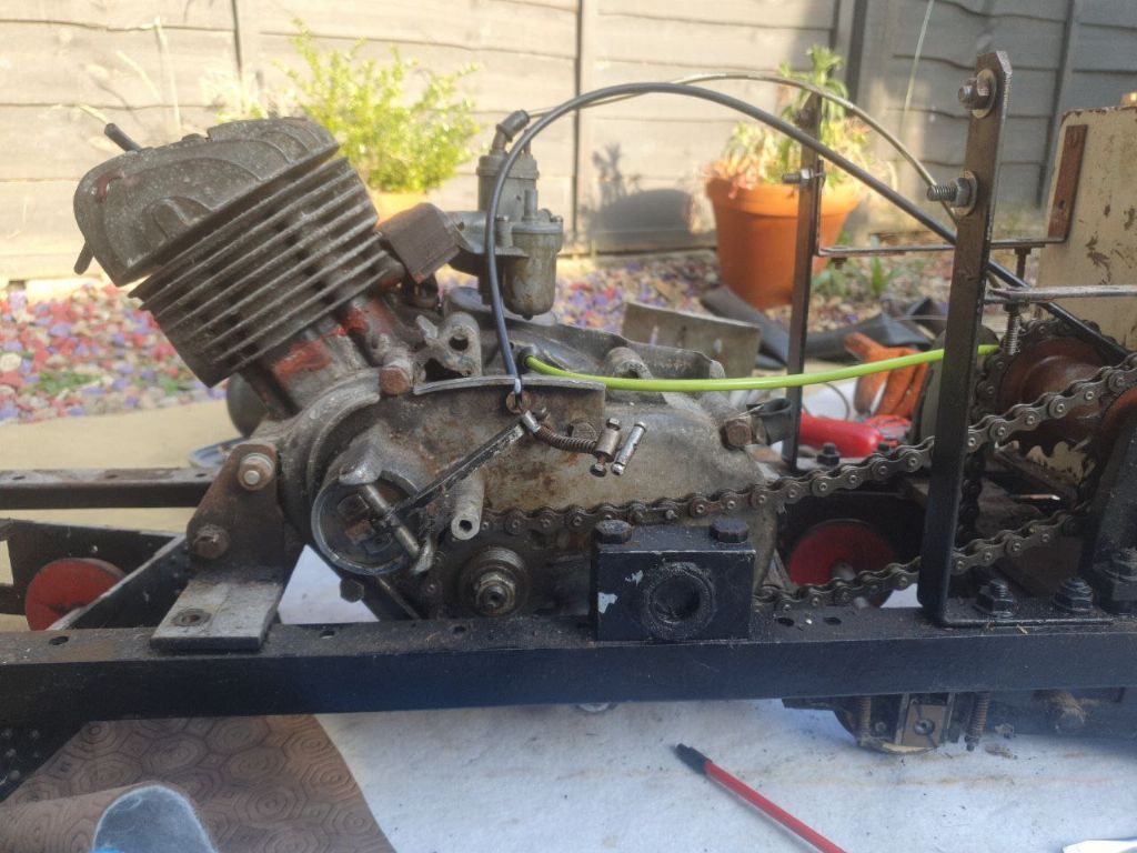

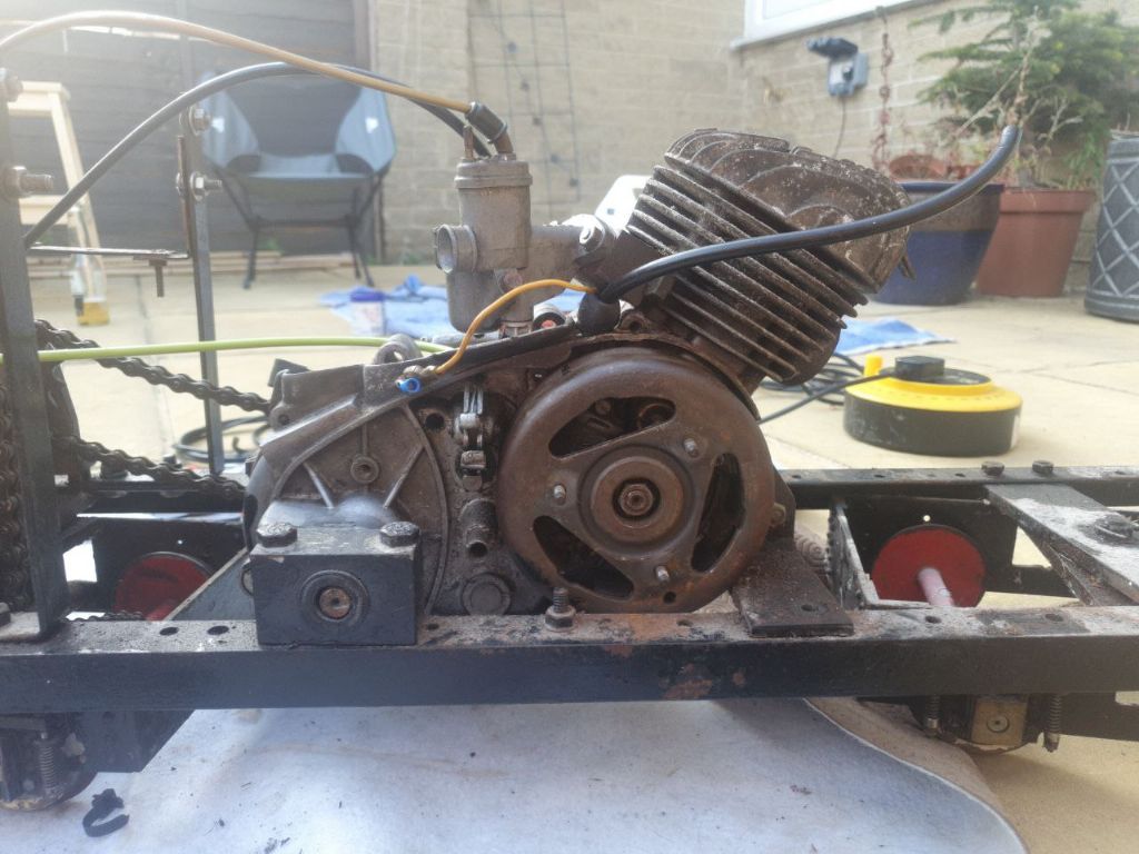

Hi Folks,
I recently purchased this locomotive with an engine that appears to be from an old moped or motorbike - it's two stroke with an integrated 2-speed gearbox and what appears to be a decompression valve on the top to kill it.
Does anyone know what it is, or how I might find out? I need to get a new spark plug as the previous owner forgot to put it back in, woops!
I can't provide much more information sorry, the spark plug thread appears to be 12mm based on measurement. I've looked all over it but can't find any badge or logo from the original manufacturer, although i did find a serial number if that would help

The make of the carburettor, and number if visible, might at least help identify the country of origin.

clive: the carburettor is made by "bing", but i'm fairly confident that it is not the original carb - it's tricky to make out in the photos but it's being held away from the engine block by lump of steel about an inch long, doesn't look very factory!

NSU Quickly.
not done it yet16/06/2023 23:03:09
7517 forum posts
20 photos
NSU Quickly.
I only know of two mopeds with a 2 speed gearbox. Quickly and Mercette. My Mercette used a 4 stroke OHV engine.
Dick H16/06/2023 23:21:22
141 forum posts
1 photos
If it is indeed an NSU Quickly motor there are specialists in the net for these things. Google "nsu quickly Zündkerze" and it will throw up a Bosch spark plug.
Clive Foster16/06/2023 23:23:03
3630 forum posts
128 photos
+1 for NSU Quickly.
Newnes says:-
Bosch W240T11 plug, breaker gap 12 thou, timing 24° btdc,
Carburettor Bing 1/9/1, main jet 56, needle position 2.
Shedloads of information on the internet.
Clive
Edited By Clive Foster on 16/06/2023 23:24:15
Edward Hobbs 316/06/2023 23:23:58
10 forum posts
5 photos
it absolutely is a Quickly, thank you very much I didn't expect to get an answer so quickly. The previous owner did tell me the name but I misheard it as "LSU" which would explain why I couldn't find that!
