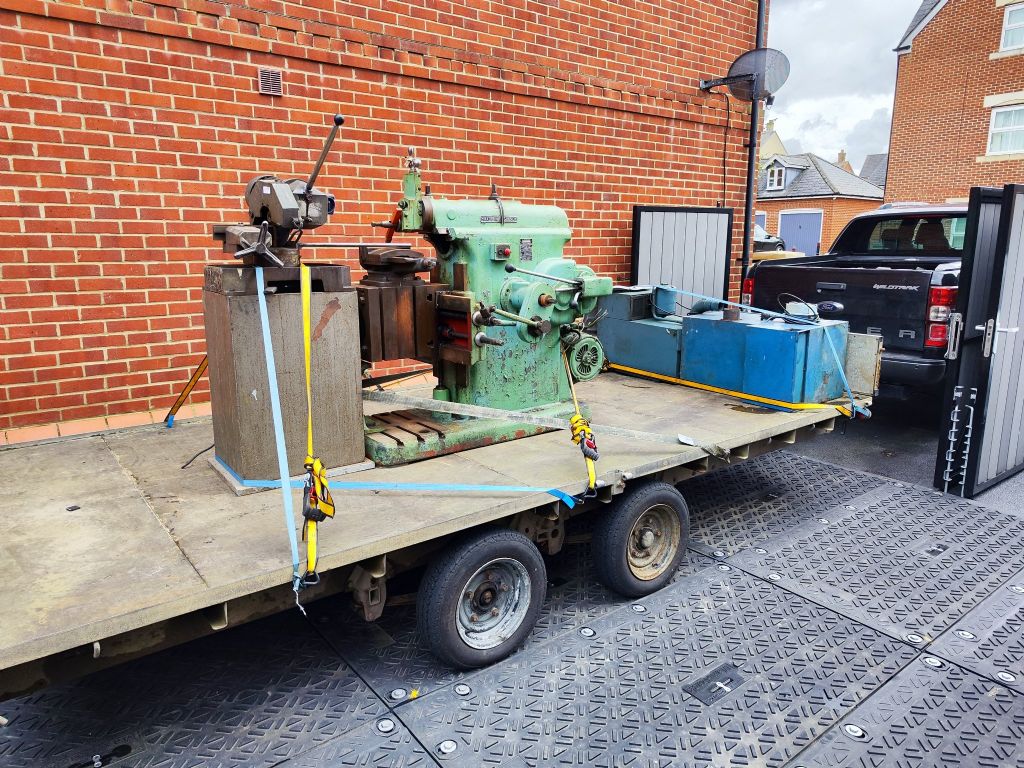

I recently picked up an Invicta 4M shaper from an auction and thought I would share a few photos.
The Invicta brand was bought out/merged/renamed to Elliott and according to the lathes.co.uk website my shaper dates to around WW2 times. See Invicta shapers which might be worth a look if you are interested.
Here it is arriving at home on the back of a trailer.
Invicta 4M Shaper
I did not really have the correct equipment at home to get the machine off the trailer. I had to resort to using a ratchet strap as a winch to get the machine to the back of trailer. Once the machine was at the back of the trailer,  my Chinese engine crane could slide underneath the trailer for me to attempt a lift.
Invicta 4M Shaper
As I was on my own, I had to lift the shaper (which the little crane could barely accomplish) and then drive the trailer out from underneath it.
Invicta 4M Shaper
Invicta 4M Shaper
Needless to say, this was not an ideal situation and I tried to stay away from the shaper as much as possible in case the crane failed. I could not lower it to the floor due to space constraints so I quickly got some wooden blocks so that I could lower the machine onto them.
Invicta 4M Shaper
I could then get a pallet truck underneath it to move the machine.
The machine stayed under a cover for a couple of weeks until I had the chance to have a closer look at it. Last weekend, I had a chance to have a closer look at the machine.

Overall the machine was very dirty and had surface rust on all the machined surfaces. The three V belts were also in a very poor condition.
Invicta 4M Shaper
Invicta 4M Shaper
I cleaned most of the rust off and ensured I lubricated everything that requires lubrication and attempted to run the machine.
See the quick youtube video I made.

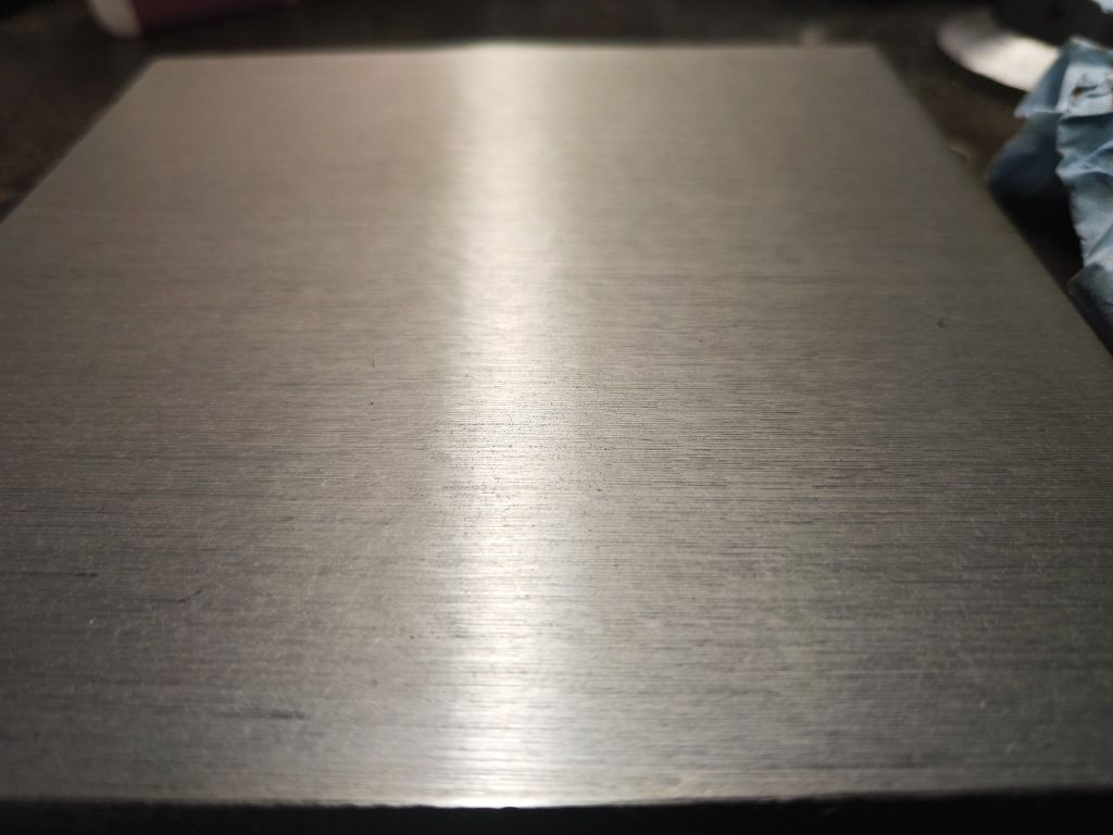

This was the result of the first cuts
Invicta 4M Shaper first cut
I am not super happy about the finish. I will need to experiment and practice to try and get a better smoother finish.

The finish can depend a bit on the material you are cutting too, cast iron and aluminium are easy to get a great finish on, steel can vary a bit depending on the grade, much as it also can with a lathe. Don't let those smoking chips go down your shirt front!

The tool has too much unsupported overhang. It will be flexing on every cut. Get a tool with as deep a shank as you can fit in the tool holder. A couple of hours on a Drummond hand powered would teach you all you need to know about shapers.

Like John Ihave found that Brass/Alu/Cast Iron is fairly easy to get a good finish on using lathe style tool geometry but for finishing cuts on steel I use the VERY old scarfing tool which seems to do the trick.

Thanks. I will experiment a little more with different tools and speeds to try and get a better finish.
The steel I cut was also 'mystery metal', it was part of an old 20mm thick road plate so probably hot rolled cheapish steel.
