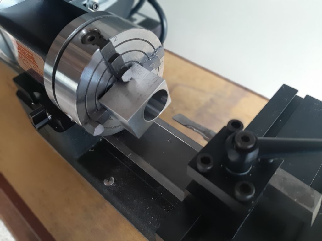

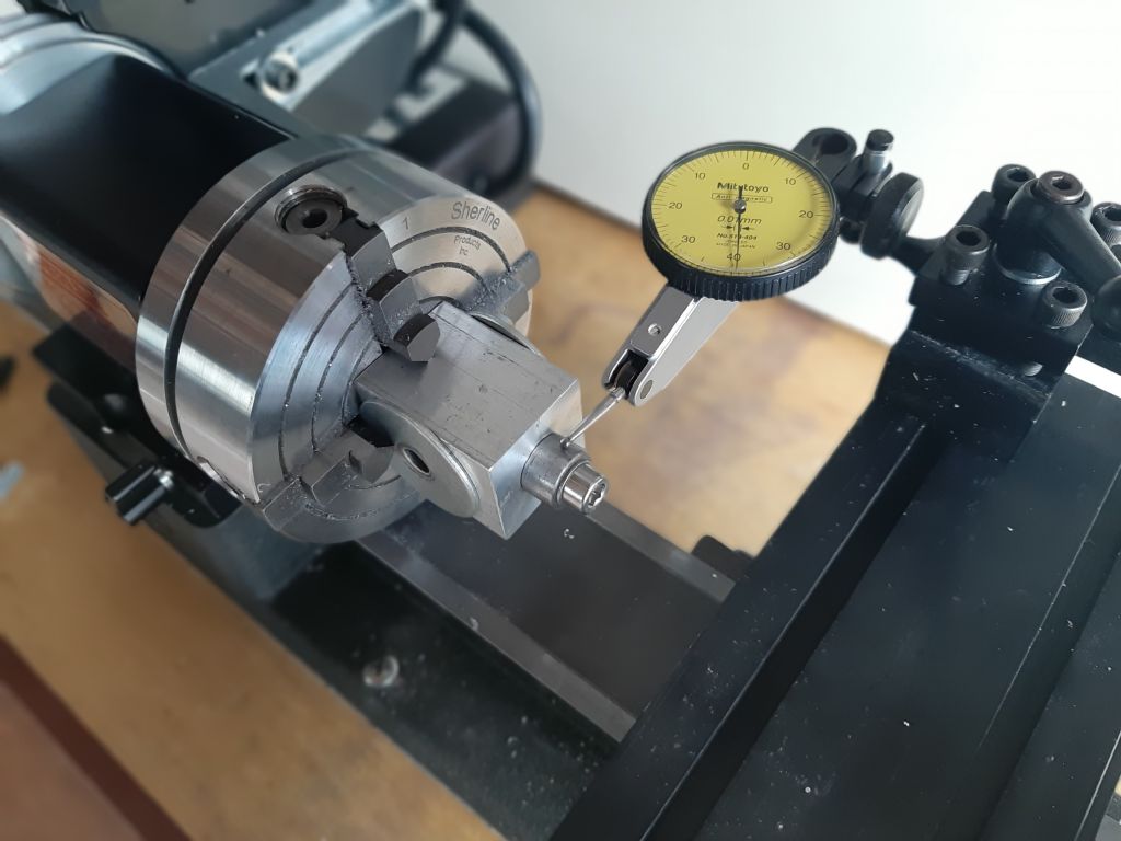

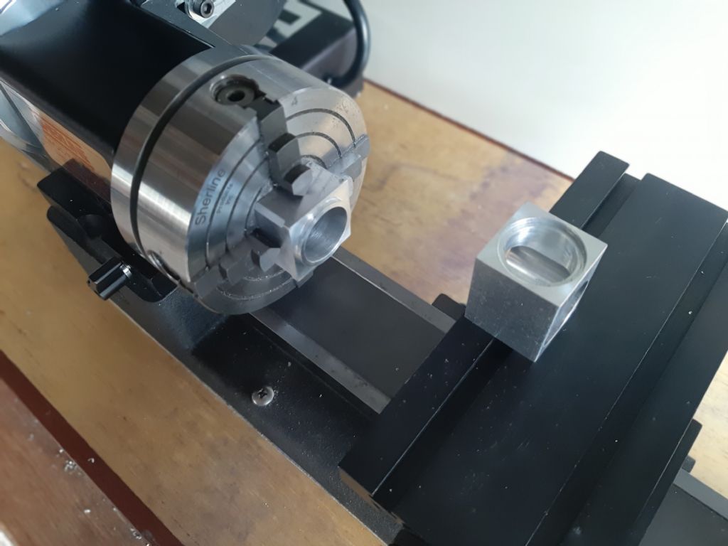

I' intend to do all the machining on the sherline lathe which is fine for most of the parts.
I decided to bore out the crankcase using the four jaw chuck. The length of the case was I thought a problem as supporting the work would be difficult. I therefore decided to to split the case into a lower and upper half to make the machining more manageable. The lower half has a recess to accept a register ring on the upper half.
I'll need longer head bolts as the threaded anchor points will be in the lower half of the case with clearance holes in the upper half. The register is a very snug fit but I still plan to silicone seal the joint on assembly.

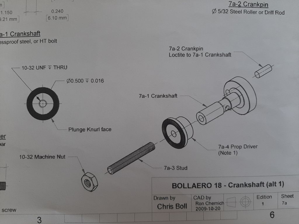

Hi All,
Ron's drawings show three options for the crankshaft. This is one of them which I believe is Chris Boll's original design.
I like this one and will probably use it.
Ron points out that using this design "may" result in a "thrown prop". What is a thrown prop?
With particular reference to this engine has anyone any ideas how this design may result in a thrown prop.
I'm just curious, the design seems sound to me but perhaps I'm missing something?
Geoff

Hello Geoff,
A 'thrown prop' is when the prop becomes loose - usually when flicking to start it. The engine comes up on compression and the force loosens the prop nut. For the most part it's just a matter of retightening it but if it occurs a lot it's best to redesign the prop driver to something more practical. Some commercial engine shafts have straight knurling with the prop diver forced on, others a slotted drive but the easiest to make and sound in design is the tapered brass collet in a taper bored prop driver - the taper needs to be an exact match though for optimum drive.
It is said that throwing a prop can lead to the engine having a shaft run - ie the prop coming off and the engine continuing to run totally unloaded but having hand started engines for so many years and throwing props on many occasions I've yet to experience that happening. Indeed in 65 years of playing with diesels I've yet to meet anyone who has!
I have some pics of the taper collet system so I will upload them for you
Best - Tug

geoff walker 123/07/2023 12:29:37
521 forum posts
217 photos
Hi Tug,
Thanks for your reply.
I can see how a collet driver will be locked very tight on the shaft.
If the driver is not REALLY secure on the shaft then it may shift marginally and loosen the nut. Does that make sense?
In the design above the driver is screwed onto the shaft and then presumably it locks in place when it butts up against the end of the shaft, but perhaps not secure enough to prevent it coming free and loosening the nut.
After your comments I'll look at the collet option in Ron's drawing
Thanks again Geoff

Geoff - if you are able to incorporate it the tapered collet system is the best of all allowing tight grip but easy removal. The angle wants to be 15 - 20 degrees (30 to 40 inclusive) too fine and it can lock. Don't make the collet from ali as it will in all probability gall and bind solid

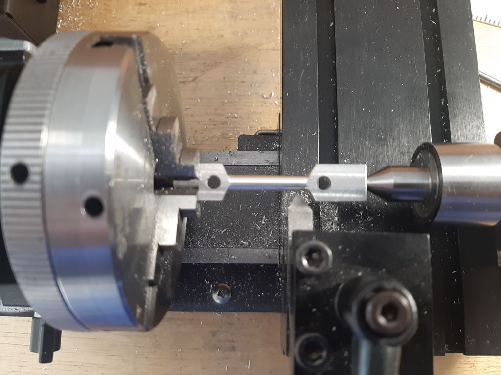

geoff walker 126/07/2023 16:10:17
521 forum posts
217 photos

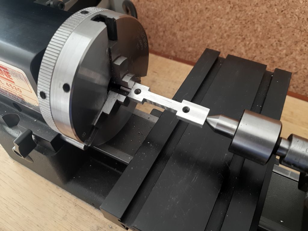

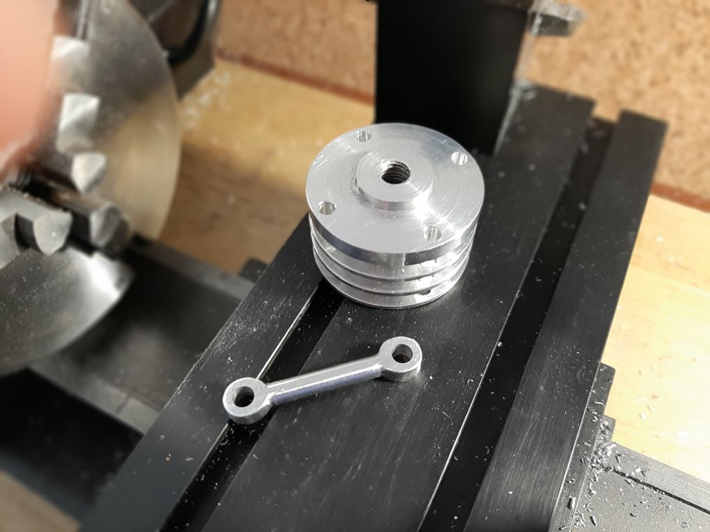

Some more progress today.
After some initial milling, shaping and drilling, set up the con rod on the Sherline.
Perfect for the smaller items.
Last photo shows it alongside the head, finished after some nibbling on the mill and some judicious filing.
Geoff
