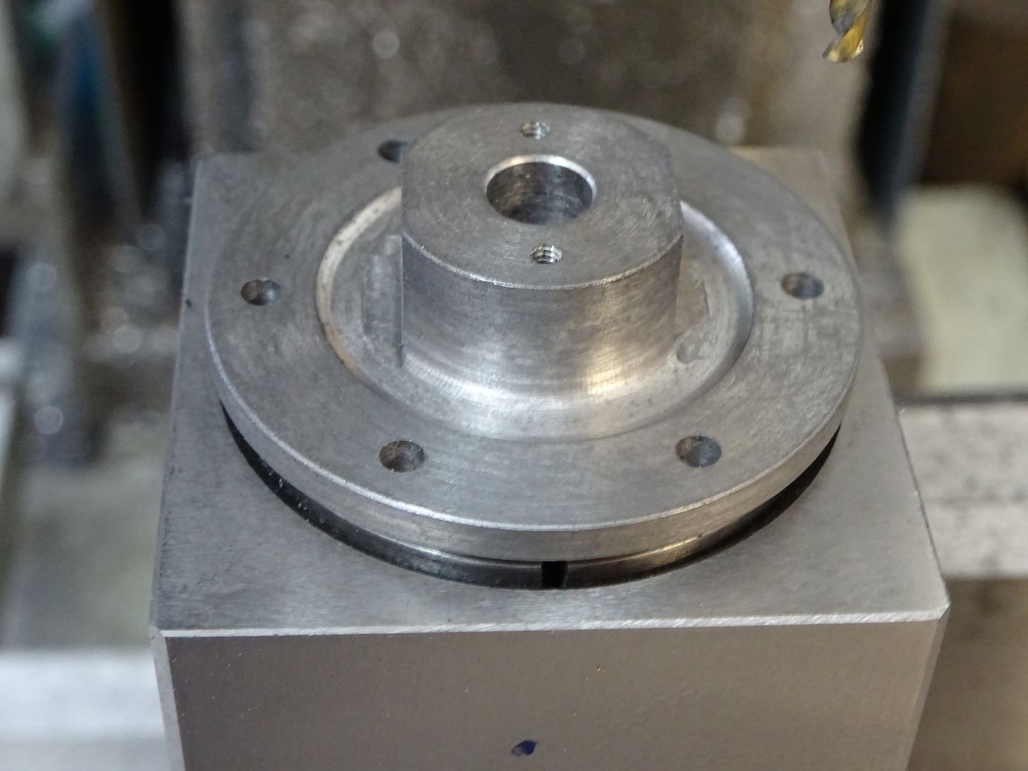

As they are single taper you don't have to worry so much like you do with ER, I've happily worked on items held by 0.75mm 1/32"

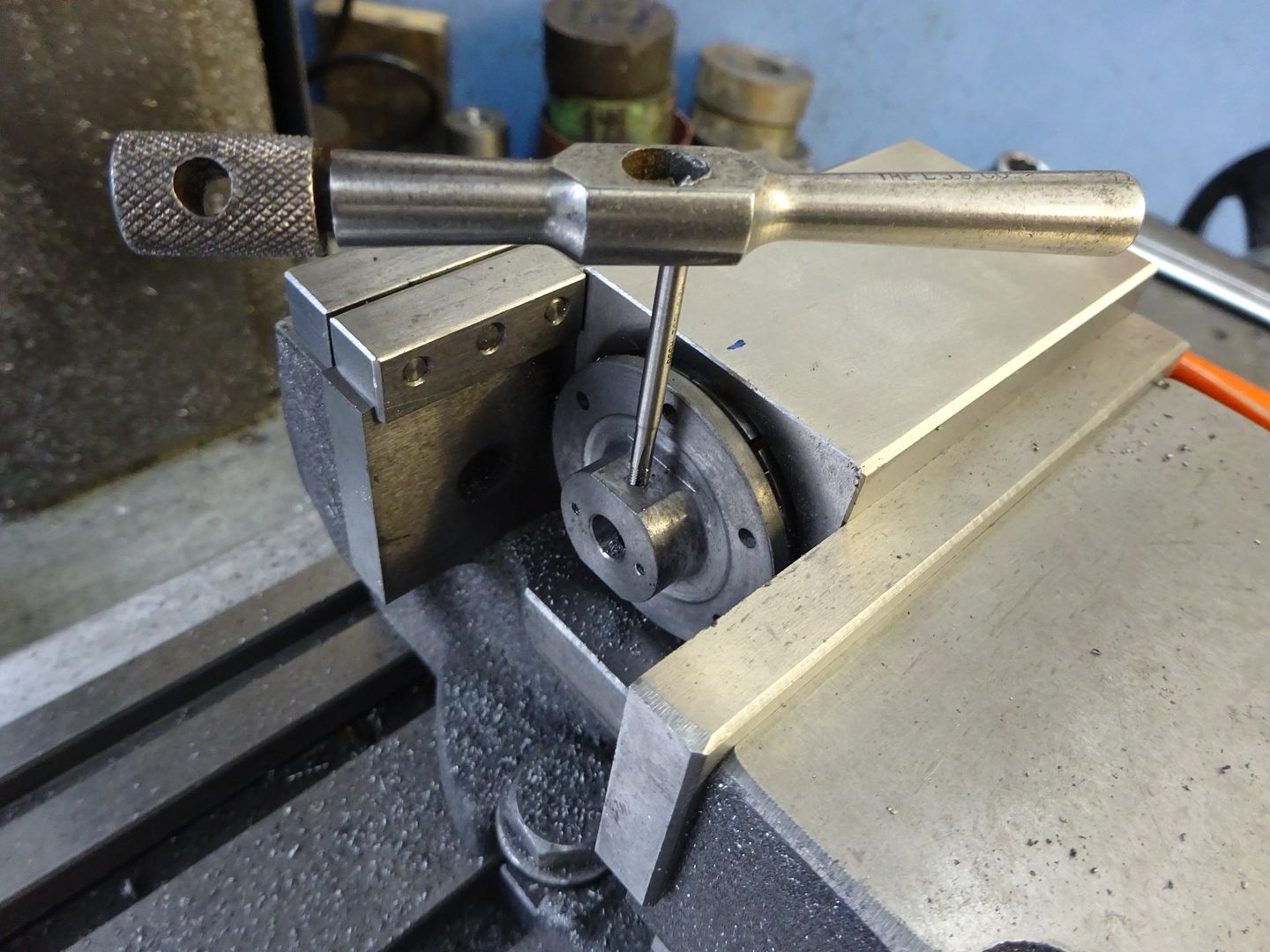

I probably mostly use it like that for drilling an milling cylinder end covers holding by the short spigot that goes into the cylinder so can use the larger face to push against the end of the collet. If no step I will hold collet front end down against bench and push the item down from behind while tightening

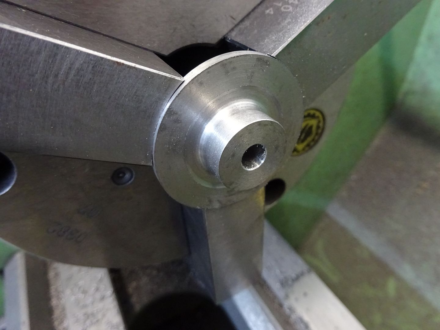

Turning flat parts I'm more likely to use the soft jaws so there is something to push the work back against
