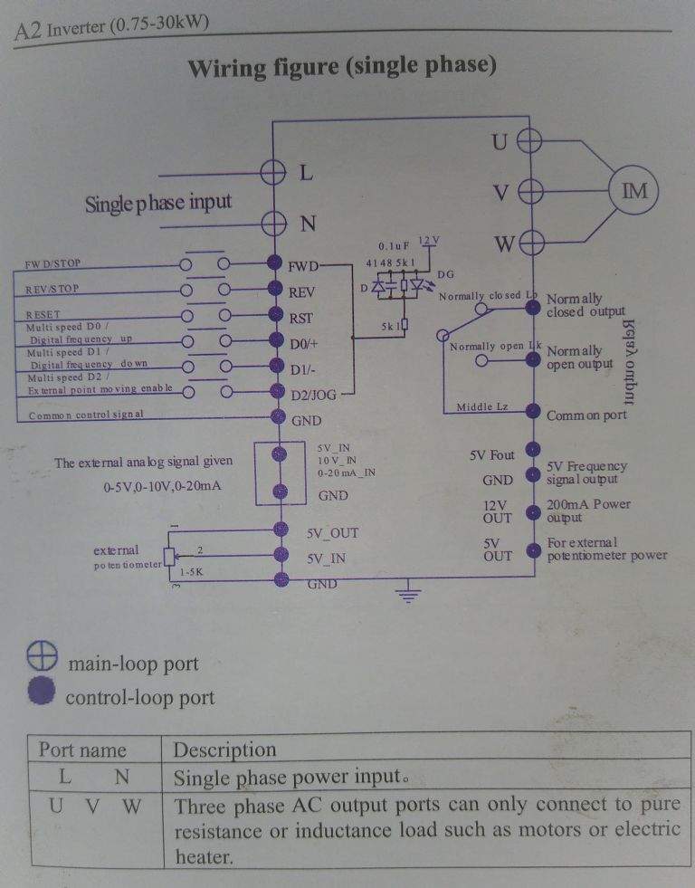

In a prevous thread I asked about matching a VFD to a motor. I have now run the motor (3ph) from a VFD (240v). All is well, the motor respond to the VFD inputs.
I want to arrange a remote (from the VFD) control. The photo shows the wiring connections for doing this. Stop/start and forward/reverse with an emergency stop if possible
I have some questions. Looking at the wiring diagram, can I have a single press button switch to stop/start before the forward/reverse switch, this being a toggle switch, on-off-on? That is to say select for/rev then switch on/off from a switch fitted before those two switches?
For an emergency stop switch would it be okay to fit a normally closed stop switch (big red button!) before the stop/start in the previous paragraphs arrangement?
Would I be correct in assuming that the switches shown in the diagram are latching, not momentary?

There is usually only one switch for forward/reverse, open motor goes one way, closed it goes the other. Then a second switch can be used for run/stop as you require. This is the way I have my mill set up. My lathe is set to run forward or reverse from a single switch that is the original lever switch for the lathe.
On some VFDs you can select if the switches are latching or momentary. In most cases the VFD will not start the motor if the run switch is on when the VFD is switched, on as a safety measure. This means a simple on off switch can be used safely as the run/stop switch.

Photo I forgot to post!

As Martin says the inputs are normally programmable. The diagram does not really make sense. They have shown the symbol for momentary switches but assigned FWD (or REV) and stop to them This is contradictory. Also it's not clear whaat RST does.
Normall the Emergency Stop has it's own input.
What make and model is the VFD so we can find he manual?

It looks like you have this VFD A2 VFD manual
The front panel has membrane switches so the unit is set up to start and stop when a membrane switch is pressed, you don't want to be standing there holding the switch down with your finger for hours. In order to use on/off switches you need to be able to change the way the VFD responds to an external input. Looking at the list of parameters this may be what settings Pn04 and Pn05 do. Setting an external switch for the run command (Pn04=2) and clockwise/anticlockwise enable (Pn05=3) could be what you need to do. Then an emergency stop would just require putting in series with the run/stop line to stop the motor but would not switch off the VFD. It should be easy to work out if this works the way you are hoping for.

Thanks all for the replies. Martin C, thats the one, the manual seems to explain the settings for remote control.
The one thing I am not sure of is the swithces to (externally) control the device. As drawn in the circuit diagram they are momentary. Is that intentional or just poor interpretation of wiring diagram standards?
My thoughts are that these should be latching switches so as to provide a path for the selected parameter as other VFDs do.

If the switches are latching, then several could be closed simultaneously unless, maybe, a rotary or change-over switch is used.
Other vfds don't necessarily use latching switches, the remote on my Teco 510 for example.

The external switch circuits are low voltage (12V) so I would just connect a wire to the ground terminal and touch the Run terminal with it to see what happens. If it only runs when the wire is connected then a normal on/off switch will work as you want. A second wire from ground to the Rev terminal should confirm that a forward/reverse switch will work the way you want as well. This is assuming you have set the parameters for an external switch.

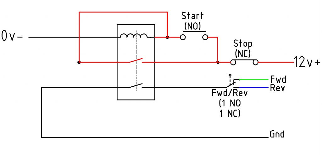

I have one of these installed. The remote switches are not latching, they are expecting an ON/OFF switch and a FORWARD/REVERSE switch.
I got round the problem by adding a double pole relay where the coil is energised and latched by the START button and the STOP button breaks the power to the relay coil. One Pole of the relay is Forward and the other is Reverse. The FORWARD/REVERSE switch powers the correct relay pole. Output contacts of the relay are connected to the VFD Forward and reverse teminals.
There is no emergency stop on this VFD, but you can tweak the parameters for stopping by reducing the time delay.

Thanks for the replies. I still have the motor temporarily connected to the VFD so was about to do as Martin C suggested then the reply from Peter S appears confirming that the switches are momentary.
I have also found another forum thread about this particular VFD (via a google search). This thread has a useful list of parameter settings for remote operation.

Peter Sansom18/02/2023 11:20:48
125 forum posts
4 photos
Fwd to Fwd VFD,
Rev to Rev VFD
Gnd to Gnd Vfd

Posted by Martin Connelly on 17/02/2023 11:11:22:
Martin C
+1 for a test, because the manual doesn't specifically say in words.
However I read it as calling for Momentary Switches. Reason:
  • The diagram shows a two pole relay switch conventionally, suggesting the diagram's momentary switch symbols are deliberate.
  • Key pads, which are popular for controlling this type of device, are almost universally momentary.
  • The FWD and REV switches are both labelled dual function, FWD/STOP and REV/STOP. I think pressing FWD once starts the motor and pressing it again, stops it. Likewise, when the motor is running, pressing any of FWD, REV or RST once will stop the motor. All momentary, the latching is done by the controller, not mechanically
  • RST is the emergency stop. Press it once, and everything stops - no need for a latching switch
  • D0 and D1 which increase and decrease frequency (ie motor speed) are logically momentary functions, definitely not latching
  • D2 jog is also a momentary function, definitely not latching
Best to confirm by experiment though - the manual might be misleading. Be careful not to poke wires into the power terminals, L N U V W.

I now have the VFD wired up and working as I want. One thing though, I needed to use latching rather than the momentary switches shown in the wiring diagram.
I found this out by experimenting as suggested, ultimately with permanent temporary(!) wiring to verify all was well with the VFD using latching switches.
Any thoughts on this?
I've looked at several VFD manfacturers installation instruction and have not come across another VFD that uses momentary switches (jog function excepted). Also no mention of shielding cabling to avoid stray signals in the manual, did that anyway, other maunfacturers always mention it.
One final question, would it be possible to fit an emergency stop, Normally closed, latching. to the GND feed to the remote switches?

The cheap Chinese VFD's seem to expect a latching switch, a relay can be used to turn the momentary switches into a latching Switches.
I have a Bosch Rexroth VFD's to install and they can be configured to use latching switch or momentary contact switches.
