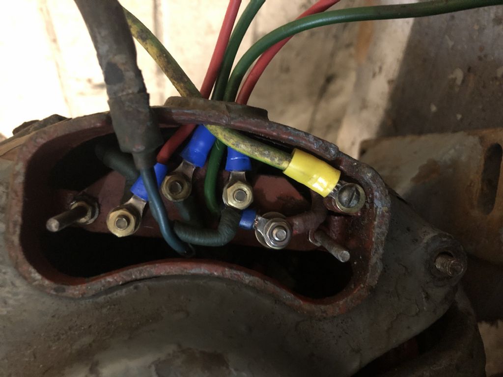

Well my latest project has been restoring some of the original features to the mill. Namely switchable reverse for the motor. The motor that’s in it is a single Phase 4 pole crompton Parkinson’s motor. And ran fine before I touched it.
however it was missing a stud for breaking it out into four wires and was wired directly to a mains plug. I’ve added a stud and separated out the wires into the original chock block. However once wired up to my switch, it’s running very slowly, humming loudly and then blowing the plug fuse. So I’m assuming the starter capacitor isn’t doing its job, or isn’t wired into the correct place. I have however left it where it was previously.
this is the original way it was wired
heres how I have it
and here’s the switch diagram I’m using
while I do know a little bit about electronics, I don’t really have a lot of experience with induction motors. So hopefully I’ve just made a silly mistake and one of you good folks could point me in the right direction?

the motor will turn both directions, so the windings must be connected up right. the capacitor has now been tested and seems okay. so the capacitor connections must be wrong?

Are there any markings inside the terminal box or maybe pasted inside the lid? A, AE, AZ, Z, K, T, S or what?
There are at least 5 different types of single-phase motors each wired differently; they can have zero, one or two capacitors (sometimes in the same cylinder), and a centrifugal switch, or not! And sorting out reverse adds another layer of complexity. Quite a few combinations to try unless some clues are found, and some cause magic smoke.
At least one capacitor being visible means it's not a split-phase motor, but it could be:
  • Capacitor Start, Capacitor Run (2 variants), or
  • Capacitor Start, Induction Run (has centrifugal switch), or
  • Capacitor Start and Run.
Also, can you see the wire colours on the motor side of the terminals? Crompton Parkinson favoured Blue, Red, Yellow and Black, where Black and Red are always the Run winding. Yellow and Blue are the Start winding, and reverse is achieved by swapping Yellow and Blue over. But the capacitor(s) and switch have to be right.
The switch diagram looks OK to me: U1 U2 are Run, and Z1, Z2 are start, but there's no clue as to what type of motor is connected, so we need to identify what type you have. Do you have a multimeter?
I hope Les Jones and the other motor experts will be along soon. Single-phase motor aren't my best subject!

the terminal box has no markings whatsoever and while there was the dry, flaky remains of what may have once been a sticker on the inside of the cover plate, there is nothing left to identify exactly whats what.
having had the back of the motor case off, there is a centrifugal switch inside so that would indicate capacitor start, induction run. if it would help next time im out i can pop it back off and take a photo of the inisde wiring?
the internal wires are all black, however the two pairs do have matching insulation over the terminals, with the start windings being red and the run windings being green ( confusingly the capacitor itself has the same green insulation around the terminals where they connect to the terminal block)
i do have a multimeter, if you point me at what to test i can get some readings.

In a section of Tubal Cains model engineers hand book is a series of circuit diagrams. First I would sort out getting it to run one way and the other. Then you can sort out the reversing switch. What sort is it Santon, dewhurst ?. The start windings may be blue and yellow, the run red and black.. Z1 and A1(U1) linked To live. wire from Z1 to centrifugal switch and then the cap and into the start windings. Other end of start windings to Z2 and linked to A2 (U2) neutral. reversing Z1 and Z2 are swapped. Noel.

Well, after moving the capacitor into series with the cut out switch. and running the wires directly to live and neutral. i now have a clockwise spinning motor!
i take it that the two going to live will be my U1,Z1 and the two going to buetral will be my U2, Z2 for the purposes of taking this to the switch?
