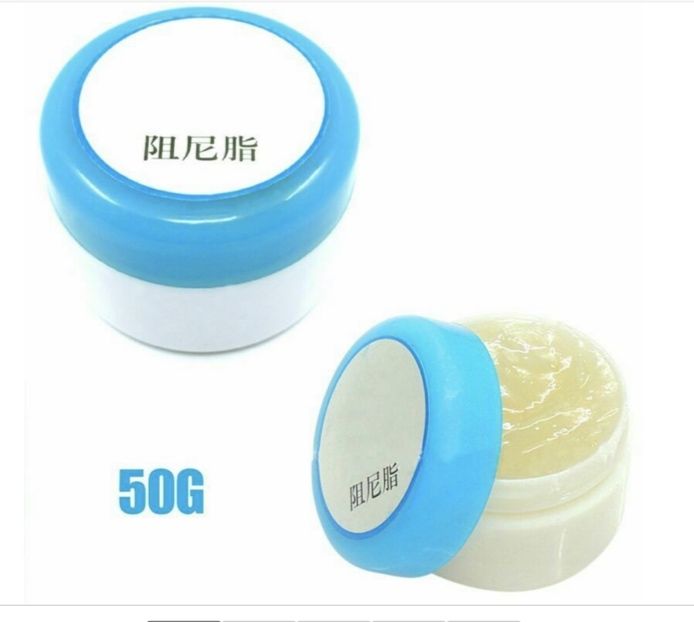

I'm attempting a repair on a compact digital camera. At the base of the lens there's a rotating bezel which is a push fit over a plastic ring, which also rotates when the bezel is turned.The whole thing is about 50mm diam, by about 5mm deep. When I took it apart, the only link between the two seemed to be some sort of high viscosity grease- not an adhesive.
If I want some similar grease, can anyone give me an idea what to look for? Or what I might use as an alternative?

Look on ebay for some high viscosity grease in a small plastic tub with a pale blue lid
… it works for me
I would post a link but it would probably be removed

That ebay grease is rather elusive, but if "high viscosity damping grease" is searched for, there it is.

and [as it happens ] those are the very words I used in the ‘Brief description’ of the photo in my Album

 As it happened, there was an easier source of the very thick grease that will not migrate into unwanted areas, the grease used for car disc brake mechanisms. it comes in little sachets and is likely to be available at a car spares shop, quicker than the post from China.

Have a look in my Album [ and no, I haven’t just edited it ]
https://www.model-engineer.co.uk/albums/member_photo.asp?a=58598&p=916838

Thank you Robert and Michael, that looks like exactly the sort of thing I'm after. There's someone on Ebay selling 1g tubs of something called Nyogel 767A for a fiver (and other variants), which seems the easiest way to go. We were quoted about £250 for complete new lens assembly so I'm feeling quite pleased with myself.

I will just mention that when I wrote “it works for me” I was referring to the fact that I have used the Chinese grease very successfully on the helicoids of adjustable microscope eyepieces.
